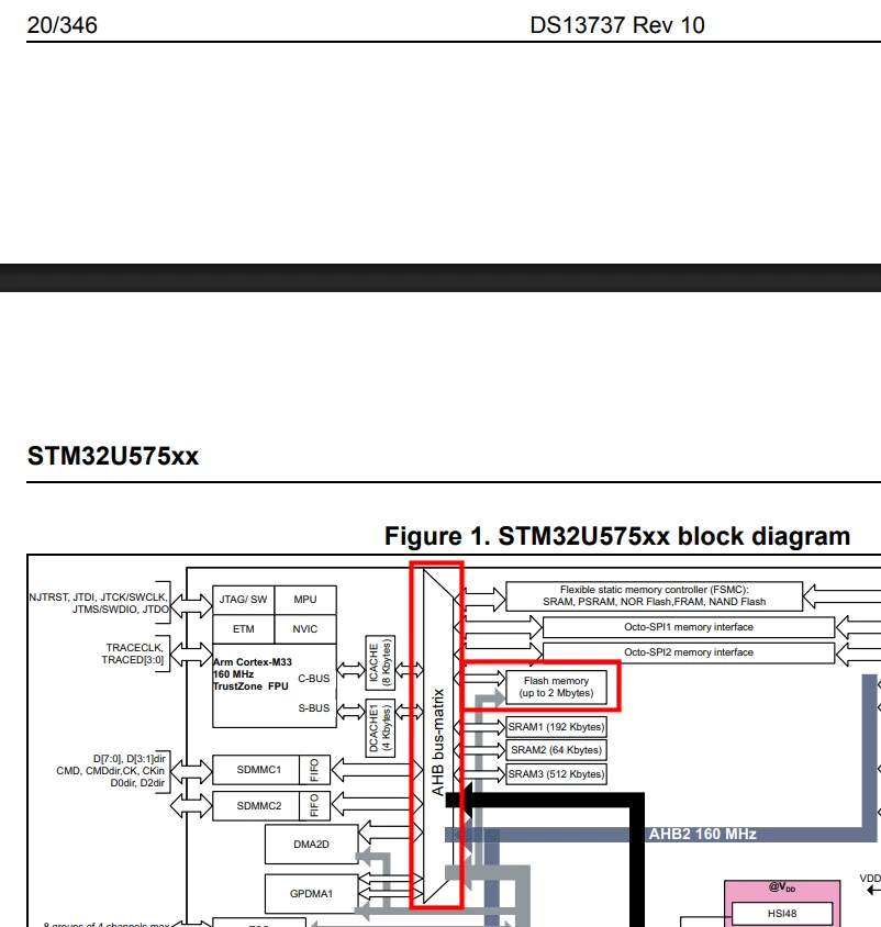

I am wondering what is the memory interface of the embedded 2MB flash? Like is it SPI .etc

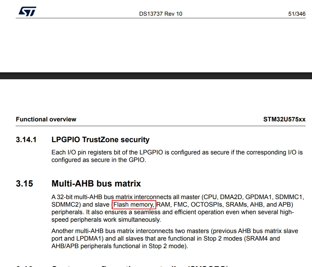

There’s a block diagram in the Datasheet - it shows that the Flash on the AHB bus:
https://www.st.com/resource/en/datasheet/stm32u575ri.pdf#page=21

yycAuthor
Aug 7, 2026 2:41 PM UTC
Thank you very much!

The internal flash memory interface of the STM32U575 achieves high-speed performance at up to 160 MHz by utilizing a 128-bit wide flash read bus paired with the updated ART Accelerator (Adaptive Real-Time Accelerator). [1, 2]
The Wide 128-Bit Read Line (Parallel Loading)
Instead of fetching data byte-by-byte, the internal flash interface reads from the memory array in wide parallel lines: [1, 2]
  • Data Bus Width: Every single flash memory read operation automatically loads a 128-bit wide row from the flash bank. [1]
  • Instruction Density: A single 128-bit read cycle simultaneously extracts four 32-bit instructions or eight 16-bit instructions into the prefetch/cache registers. [1]
  • Hardware Prefetch: You can enable the prefetch engine via the PRFTEN bit in the Flash Access Control Register (FLASH_ACR). When enabled, the interface proactively fetches the next sequential 128-bit block while the CPU is executing the current one. This minimizes pipeline stalls during sequential code execution. [1, 2, 4]
