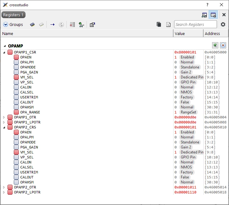

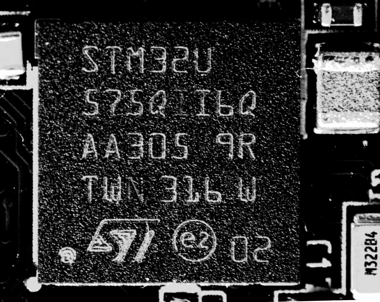

Tomas Hamouz
April 30, 2024
Hi @Amel NASRI ,
Silicon revison is W, see attached picture, all devices the same. See also the snapshot of OPAMP registers from debugger.
Tomas
Amel NASRI
May 2, 2024
Hi @Tomas Hamouz ,
Thanks for sharing these details.
Our expert made a test with a BGA169 package and OPAMP2_VINM is working properly for both modes STANDALONE & FOLLOWER.
We will try to continue investigation using a BGA132 (as it is the case for you) and will come back to you.
-Amel

> Main coincidence is the matching date and revision code
Any photo?
