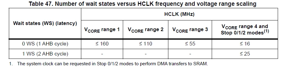

In my opinion, what is missing in this code is the setting SRAM wait states to 1 after wakeup at 24 Mhz. In RM0456 (section 6.3.4 Read access latency, Table 47. Number of wait states versus HCLK frequency and voltage range scaling), the WS must be 1 when VOS is range 4, 24 Mhz. This can be programmed in WSC[2:0] field of RAMCFG_MxCR.
However, to confirm this hypothesis, can you update your code by configuring the system clock to MSI @16 Mhz, with 16 Mhz no changes required for SRAM latency (0 WS). Then check if you still fall into a hardfault.

My test request in the comment above is to configure the clock frequency at 16 Mhz. the MSI configuration is as follow: RCC_OscInitStruct.MSIClockRange = RCC_MSIRANGE_2;. A code sample is attached.
With 16 Mhz, the voltage scaling range is 4. In this case, the SRAM WS can be 0, so you should not see any hardfault. This test is to confirm that the issue is not due to SRAM WS configuration.

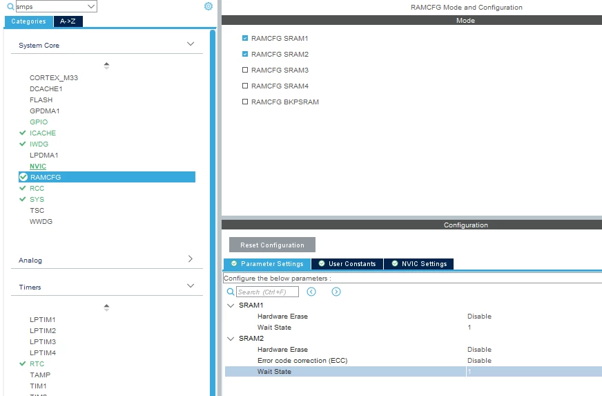

In more details, the SRAM wait state can be configured by RAMCFG peripheral which is the controller that manages SRAM erase, ECC, read access latency ... among others.
To correctly read data from SRAMs, the number of wait states must be correctly programmed in WSC[2:0] field of RAMCFG_MxCR, depending on AHB clock frequency (HCLK) and voltage scaling range, as shown in the table below.
If you are using HAL, you need to call the following API after enabling the RAMCFG peripheral.
HAL_RAMCFG_ConfigWaitState(&hramcfg_SRAM1, RAMCFG_WAITSTATE_1);
You can also follow the snapshot below of the STM32CubeMx code generator to configure SRAM WS.
