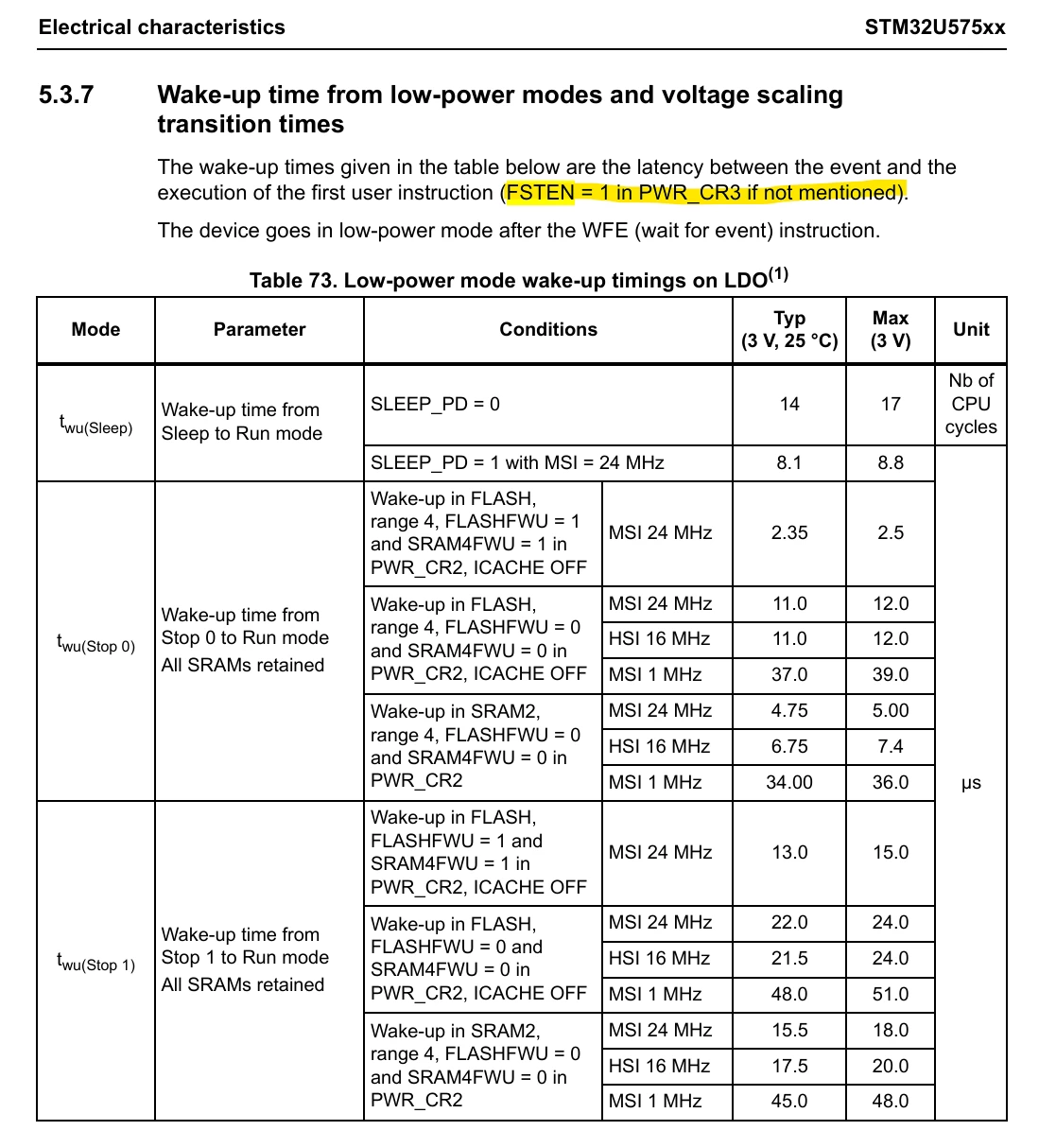

STM32U575 Wake-up from STOP3 in SRAM2
In Table 7.4, "Low-power mode wake-up timings on LDO" of the datasheet, there is no mention of the FSTEN setting in the conditions for twu(stop3)​ (wake-up in SRAM2). When waking up in SRAM2, is the wake-up time typ. 22.5 μs at MSI=24MHz regardless of the FSTEN setting?

Hello ​@YokaiX and welcome to the community;
According to the datasheet, the wake-up times given in the table below are the latency between the event and the execution of the first user instruction (FSTEN = 1 in PWR_CR3 if not mentioned).
