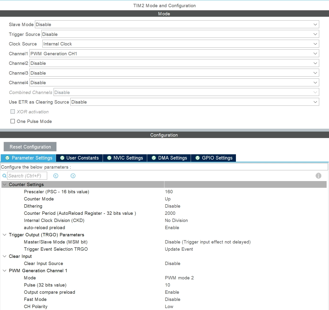

Timer configuration:
The counter period of 2000 is just a placeholder I expected to get overwritten by the DMA update.

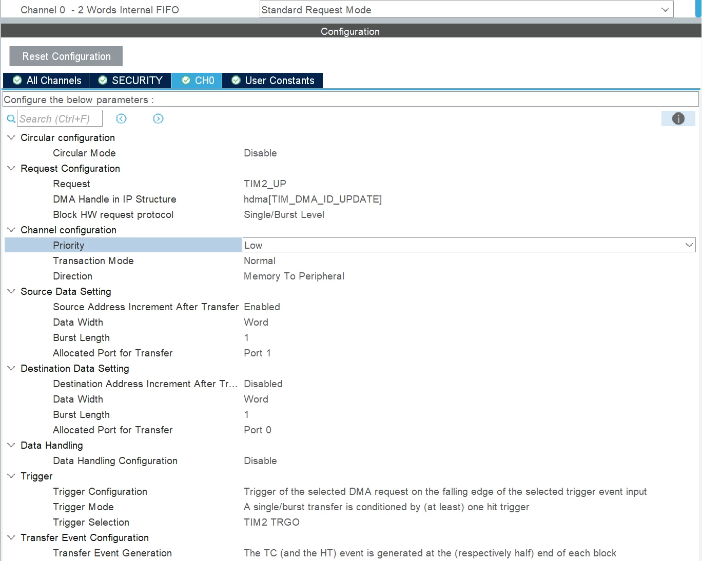

The GPDMA1 CH0 configuration:
I'm not sure if the trigger configuration is correct or even necessary.  I've tried with it disabled, and with rising and falling edge trigger, with none of them having any obversable difference.  Does TRGO set up UPDATE in the TIM2 configuration trigger this here?  If so, does TIM2 trigger an update on start, or only after the first cycle?

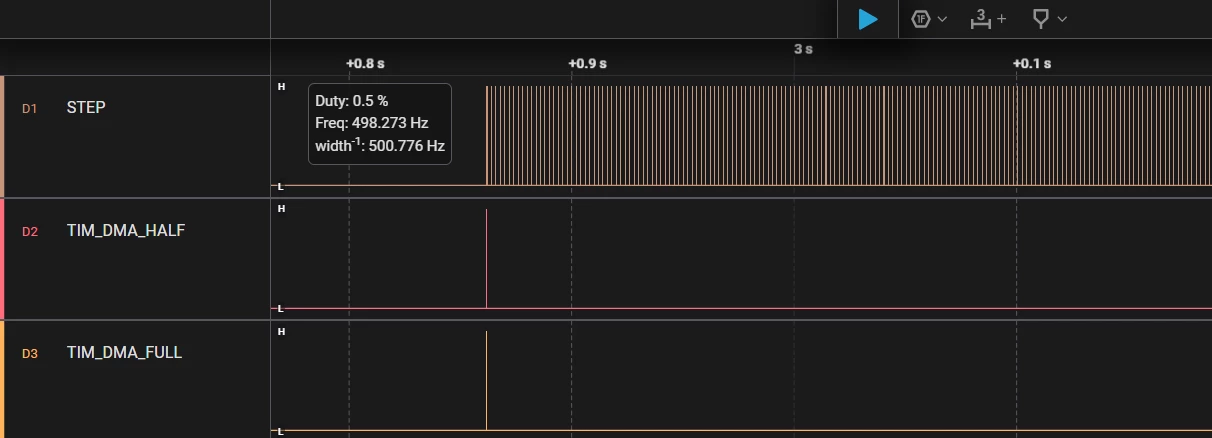

With a logic analyser, I see a steady frequency matching the 2ms period from the CubeMX configuration, not the varying frequency I expected:

TIP: It may be more convenient to initially monitor ARR using live expressions instead of relying on a logic analyzer, if all you want to do is verify that its value jumps around.  An expression like htim2->Instance->ARR should work.
note that prescaler values are always off by one. so a value of 160 actually divides by 161 - is that what you intended?
I think this is true for ARR as well (ARR=0 does nothing, while ARR=1 divides by 2).
TIM_CCxChannelCmd implies use as capture/compare, is that the right HAL function to call here?
I'd use "Live Expressions" to check whether the timer's CNT is counting up as expected after the call to HAL_TIM_Base_Start_DMA.
Have you manually verified that the calculates values stored in samples are reasonable?
You already have TIM2_UP set up as the request source for the DMA channel. I think defining a trigger for the DMA channel acts here as additional "gating" of the request, which is not what you want. The docs are very undisciplined about mixing these two terms ("request" and "trigger").

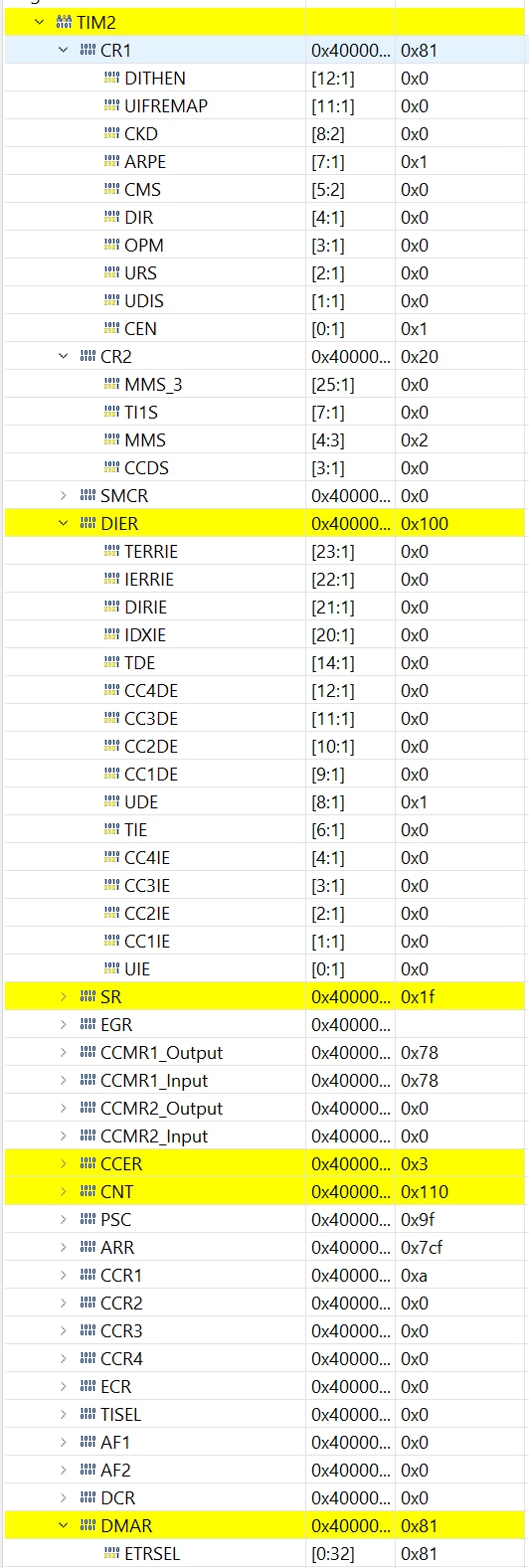

Also, check the value of TIM2_DIER.UDE. The generated code should be setting it for you, based on your configuration, but you should double-check.

Thanks for replying.  You're absolutely right about the PSC and ARR being off-by-one, my oversight there.
TIM_CCxChannelCmd might well be wrong; but I couldn't see how to enable the base timer with DMA ARR updates, and have the channel enabled at the same time unless I enabled it first.  If you enable the channel it will start the timer without DMA ARR updates, and that will likely generate unwanted pulses.  If there's a better way to do this, I'd be very interested to know how to do it.

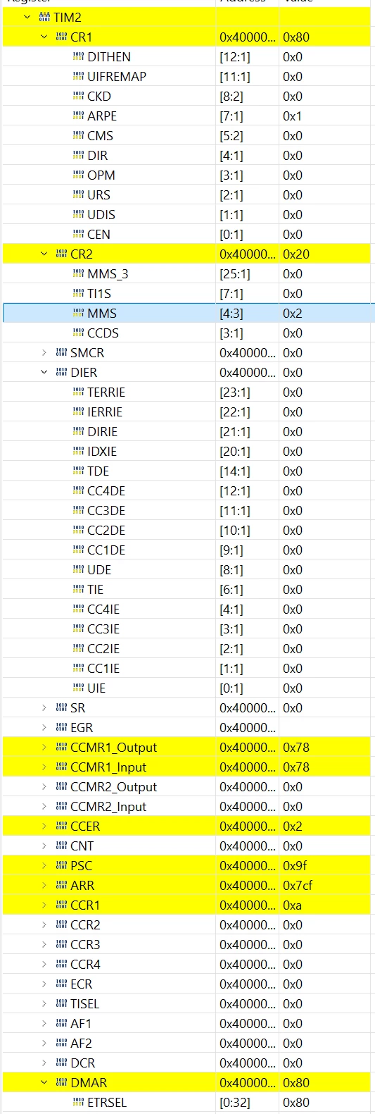

I'll look at using live expressions or data watchpoints.  I was pausing the debugger and looking at the live expression after a certain time.  But the values are all the initial values, I see no evidence of them changing if I start and stop again.  Looking at the GPDMA registers, it looks like it has all of the initial start addresses for source and destination and the number of values to transfer is the initial value--it seems it's all set up to go but hasn't actually been triggered to do anything!
"samples" is filled with usable values, checked in the debugger.
I'll disable the "trigger" in the GPDMA channel configuration, and see if I can find better documentation of what it's intended for; the GPDMA docs I've seen so far don't really go into any detail about this.
TIM2_DIER.UDE is definitely enabled.

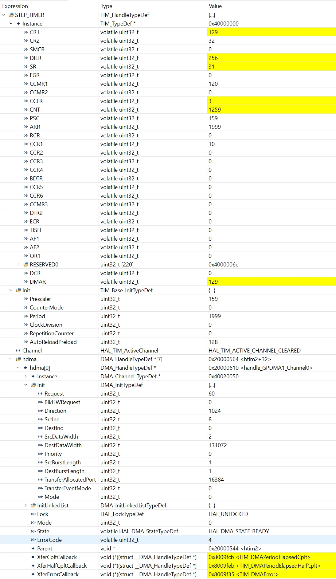

The timer is definitely started; I can see CNT incrementing, and I can also see the PWM output from the channel.  By the way I only used TIM_CCxChannelCmd here to enable the channel output before starting the base timer with DMA updates.  If there's a better way of achieving this with the HAL API, I would be interested to know what is the recommended way to do this.
I couldn't see "NDTR" in the registers or the HAL structures.  Is this the hdma ready state?

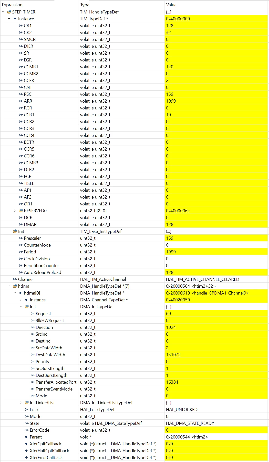

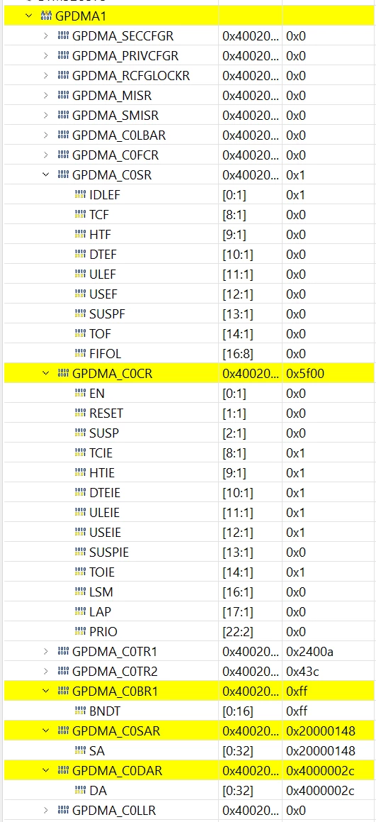

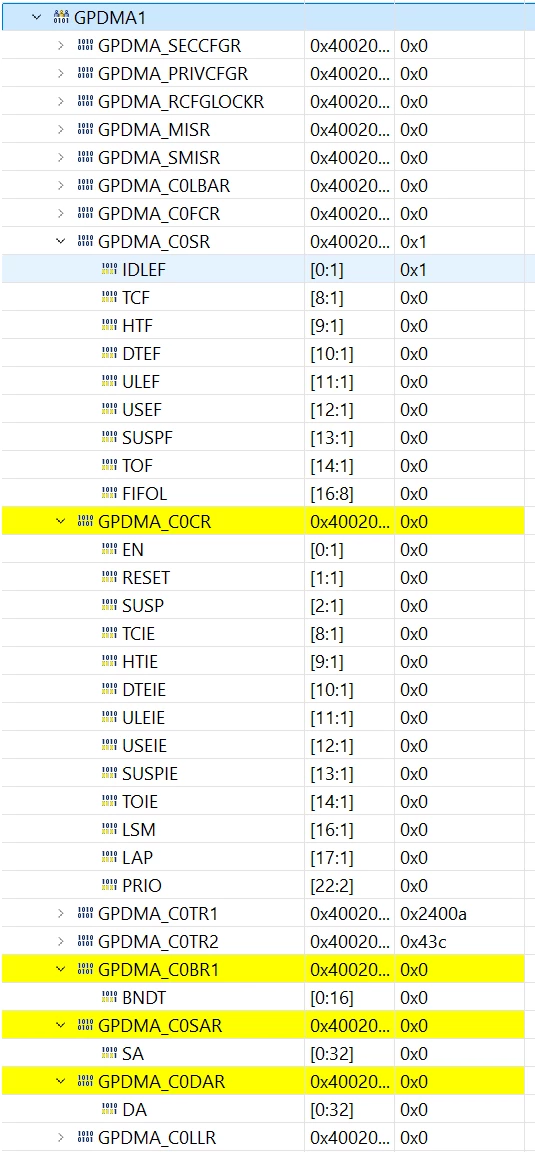

After HAL initialisation, I see this:
rleighelectradx_0-1725563212295.pngrleighelectradx_1-1725563294294.pngrleighelectradx_2-1725563394468.png
And then after starting the timer with DMA:
rleighelectradx_3-1725563476344.pngrleighelectradx_4-1725563521745.pngrleighelectradx_5-1725563553095.png
All of the DMA source and destination addresses and sample count are correct as the initial values, but it looks clear that no transfers took place.
I see that there is an error code of 4 in the hdma structure, so that's likely an indicator of the fault.
Thanks,
Roger
September 5, 2024
Indicates a user setting error:
#define HAL_DMA_ERROR_USE (0x0004U) /*!< User setting error */
In that case, HAL has determined something is amiss. Probably stepping through HAL_TIM_Base_Start_DMA would show where this happens and why. Possibly a CubeMX generation issue.
