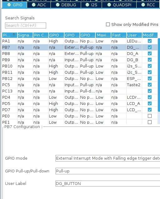

AScha.3
May 7, 2023
ad 1: set rising/falling detection on 4 or more pins , as you like ->
_legacyfs_online_stmicro_images_0693W00000bjXZ7QAM.pngthen process in INT , count++ ... timeout , etc.
ad 2: shure, it will make an int also, but ... why create complex setup, just to get a pin change level ?
