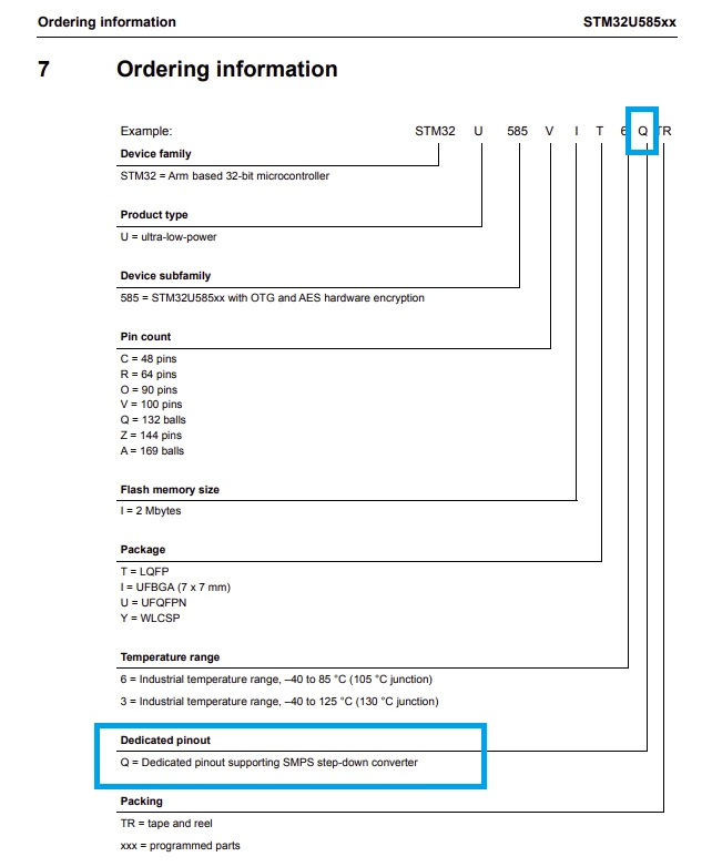

mƎALLEm
Feb 11, 2025 8:49 PM UTC
I didn't understand why are you switching between the modes between LDO and the SMPS in STM32U575 product.
There is only one power configuration according to the package (SMPS or LDO):
This is not STM32H7 having the two power configurations.
