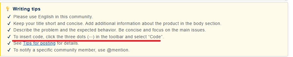

Hello ​@xukong ,
Did you read the tips before posting?
This pop-up is showing-up when you start a thread:
Please kindly follow the community rules while posting: How to write your question to maximize your chances to find a solution
Thank you for your understanding
xukongAuthor
Jun 29, 2026 9:00 AM UTC
Sorry, I didn't notice those things. I was in a real rush back then and spent days searching but couldn't find the problem.
