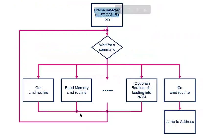

RLanz.2
RLanz.2Author
April 19, 2023
Hi
Thanks for your reply. In fact, I was actually already looking in those two ANs,
and unfortunately I still don't understand,
where it says in AN5405, in chapter 1 'Bootloader code sequence',
in Figure 1 'Bootloader for STM32 with FDCAN'
the initial state is 'Frame detected on FDCAN Rx pin'.
  1. What ensures that the bootloader waits to any input (from FDCAN or SPI etc.) and does not continue to and execute the software application already existing in the flash (as it is in a normal startup after powerup/reset)?
  2. Besides following the exact procedure to jump to boot, as you advised in our conversation above, what else is required to make sure the bootloader indeed "understands" it should wait and communicate via the FDCAN peripheral, and not other peripheral (SPI etc.)?
  3. Is there any ST host supporting FDCAN? We currently use some other non-ST host to communicate with the STM32U575.
Thank you
Roni
April 20, 2023
Hi @RLanz.2​
Q1 and Q2: It not possible for bootloader to Know what peripherals that will be use . Bootlaoder initializes all peripherals that are supported and their inputs. If bootloader detected communication on one input connected to a supported peripheral, Bootloader denitializes others peripherals (Refer to figure 1 of AN5405).
As long as the bootloader has not received a go cmd routine from host , you will remain stuck in the bootloader.
_legacyfs_online_stmicro_images_0693W00000biVPOQA2.pngQ3: ST host (HW and SW) don't support FDCAN.
Regards
Diane
