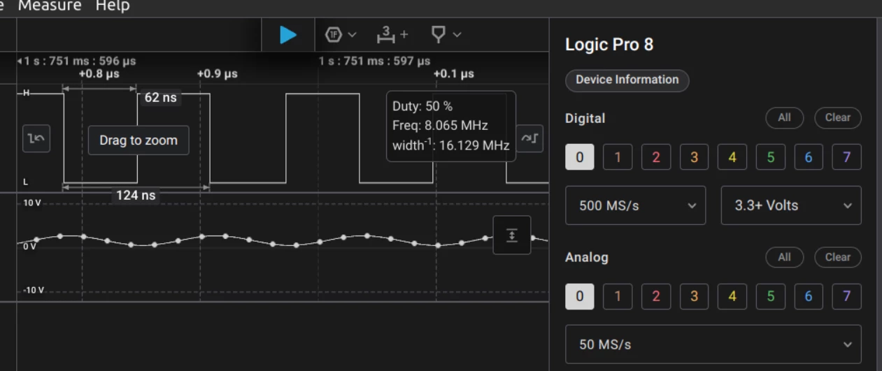

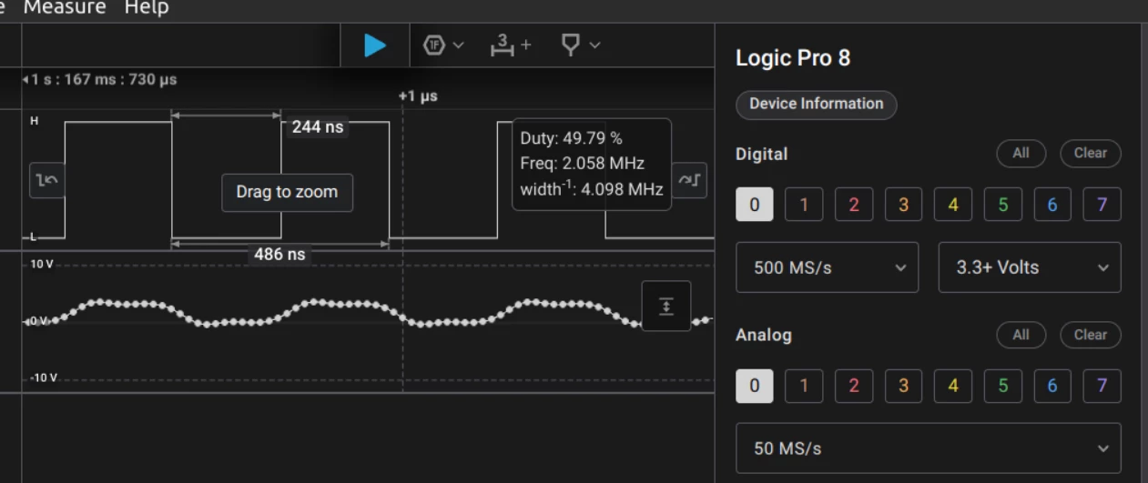

I just toggled a GPIO on my U575 NUCLEO with GPIO Speed set to Very High
calling HAL_GPIO_TOGGLE = ~ 4 MHZ
calling GPIOF->ODR ^= GPIO_PIN_13 = ~ 16 MHZ
Things to consider:
- Trigger voltage : 3.3V in my case
- HAL overhead.
- For loop overheard of comparing and incrementing that variable. In both cases my pin toggled faster in a while(1) loop than in a for loop, obviously you need a for loop to break out but the point is that there is overhead, even if its fractional it will make a difference.

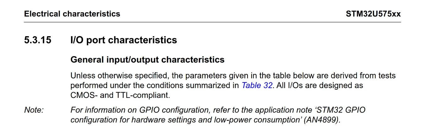

I would also suggest reading the electrical characteristics for the IO ports for your chip in the Datasheet (not the RM)

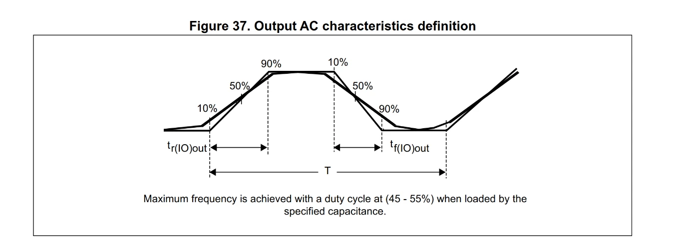

Eventually there will be a section on output frequency based on, like the previous answer said, load capacitance
