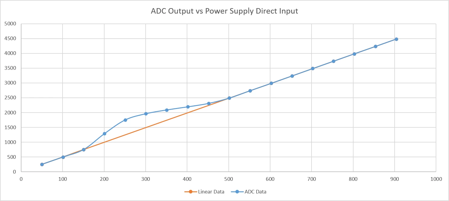

I found a problem of fixed-range local ADC non-linearity from 170mV to 480mV on STM32U545 after full hardware linear calibration.
1. Test Environment
HW: NUCLEO-U545RE-Q board (MB1841D),
Firmware package: STM32CubeU5 FW V1.8.0.
Test instruments: Precision DC power supply, function signal generator, digital oscilloscope (used to verify the actual voltage at ADC input pins).
Working Mode: Button→ LPTimer→ ADC→ DMA→ UART
MX: See attachment
Main code: See attachment
2. Two types of input tests (static DC + dynamic triangle wave, identical distortion observed)
(1) Static DC step voltage test

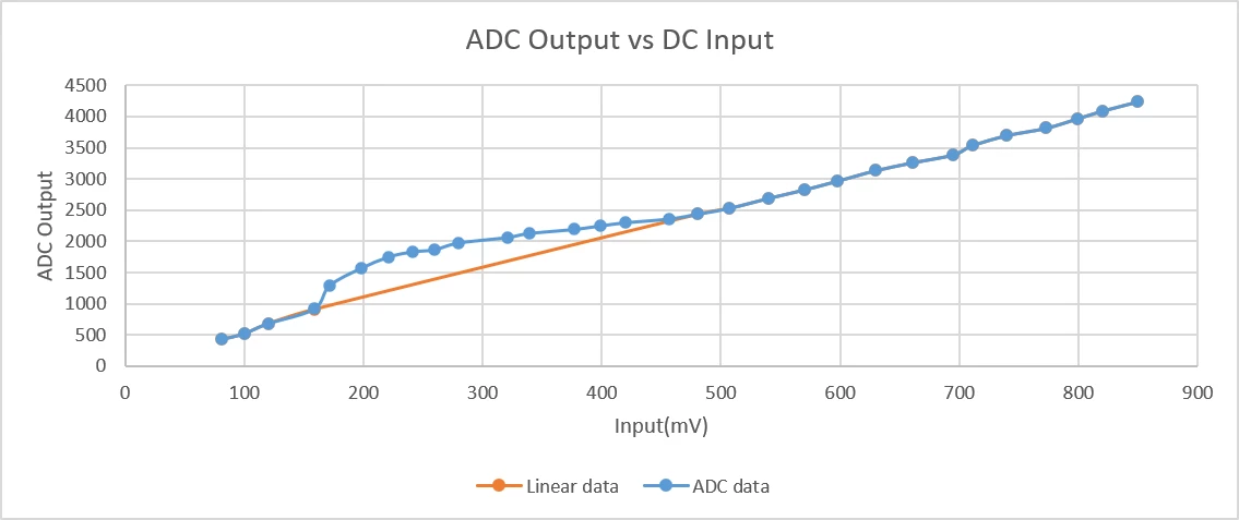

We applied stepped DC voltage from 81mV to 850mV via precision power supply and resistor voltage divider. The real voltage on ADC1 input pins was measured and recorded with an oscilloscope for every step, ruling out inaccuracies from signal sources or resistor division. Test results: ADC1 conversion curve is perfectly linear below 170mV and above 480mV. A consistent concave distortion only exists within 170mV ~ 480mV. This error occurs on both ADC1 and ADC4 (maybe not same error range in ADC4), under single-ended and differential input modes.
(2) Dynamic triangle wave test

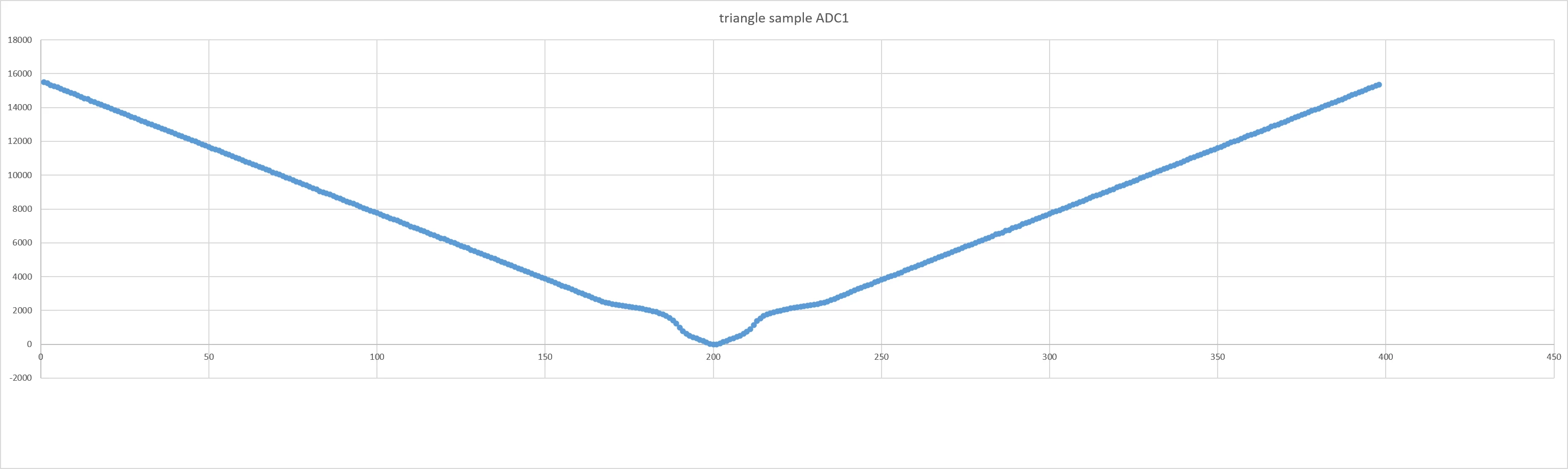

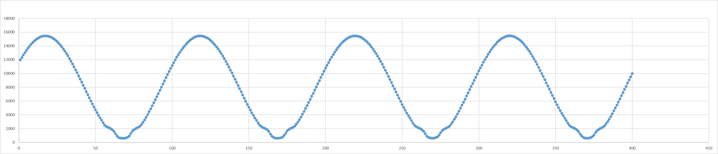

Slow triangle wave generated by function generator was fed into ADC for continuous sampling. In ADC1, The same concave distortion appears whenever the waveform sweeps across 170mV~480mV. The shape and position of non-linearity are exactly the same as DC measurement results. This confirms the error originates from the ADC internal core itself, not input signal dynamic characteristics. for ADC4, there is still a non-linear with different shape.
3. Interference factors all verified and excluded
  1. I used HAL_ADCEx_Calibration_Start(&hADC, ADC_CALIB_OFFSET_LINEARITY, ADC_SINGLE_ENDED); to calibrate, but with no effect.
  2. ADC sampling time was adjusted from 5 cycles up to 36 cycles; no change to the non-linear curve.
  3. We tested with only ADC1 enabled (ADC4 clock and peripherals fully disabled), so crosstalk between two ADC modules is not the root cause.
  4. Control test on STM32H750 with identical circuit and ADC configuration, delivers excellent linearity across the full 0~3.3V range without such local distortion.

What is the output impedance of the voltage divider?
Using a buffer or at least a capacitor on the output helps lower the output impedance.
This might solve some non-linearity.

Impedance is very important, since SAR ADC is switching capacitor load. Doesn’t matter if DC or AC, internal sample and hold capacitor generates “spike”, and it’s easy to observe with properly adjusted o-scope.
 Options: buffering voltage divider by fast OP-AMP, or simply put a capacitor 0.1uF in parallel to inputs - for low sampling rate.

Hi guys, thank you for your replies. I @ you because I might make wrong conclusion before. I thought it was impedance problem, but it is not. I tried with DC power supply as input directly, no resistor divider this time. but the non-linear still exists.
I also tried to put the integrated OPA of U545 in serial between signal and ADC, it can’t solve the problem either.
For now, I think the impedance is not the key. Only the sampling time higher than 391.5cycles can solve the problem,  68cycles has its effect but not enough. there are no choices between 68 and 391, the sample rate is not enough under 391. this is not suitable for me.

AScha.3
Jul 29, 2026 7:21 AM UTC
​@oldplaychild ,
so this nonlinearity is a defect of the 14-bit converter in U series; could you proof with a simple measurement , with low input impedance or cap o input, on ADC4 (12bit , different architecture) that there is no such problem ?
>Layout mismatch of the bridge capacitor plus switch parasitics create local non-linearity, most obvious in the 170 mV ~ 480 mV input range, where both capacitor segments work jointly and charge coupling heavily relies on the bridge capacitor.
Seems the problem should be away or smaller , if ADC clk is slower; so try using a lower clock for the ADC , set prescaler →
and use medium sampling time, try 12 cycles. So effective sample rate is still fast enough.
The nonlinearity should disappear at lower internal ADC clock.
So using the differential input mode should improve this, could you try it on ADC1 ?

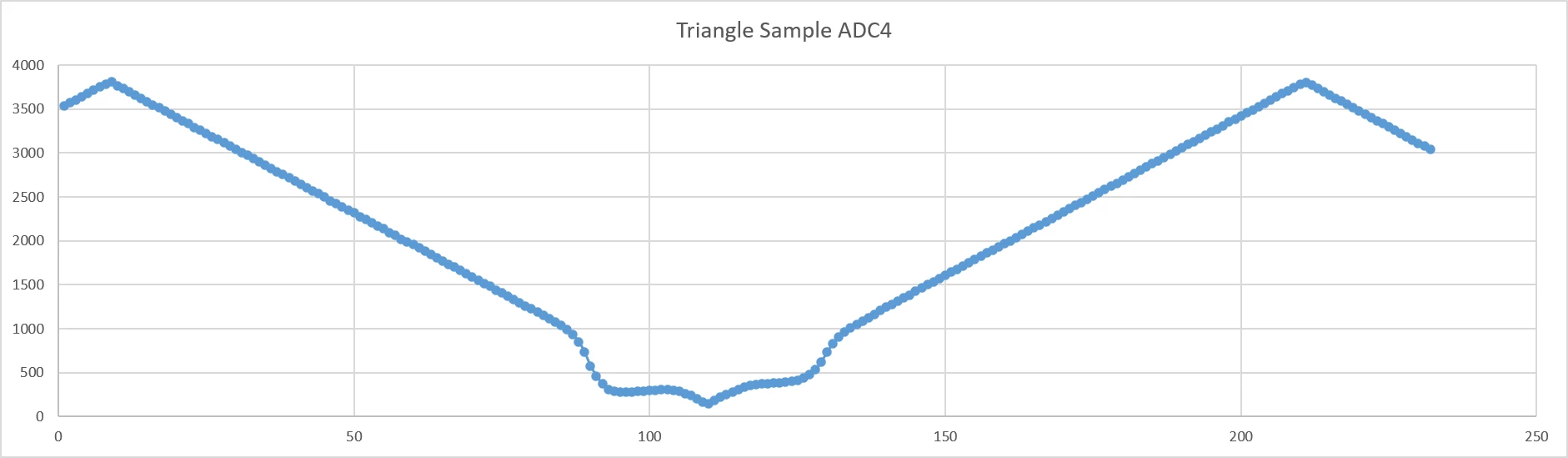

On ADC4 there is also this problem with 50ohm signal generator, not sure if it still exists with power supply directly, I will try later.
About the clock, it is a good idea, we may be able to find a balance between clock and sampling time, to achieve best sample rate without nonlinear.
