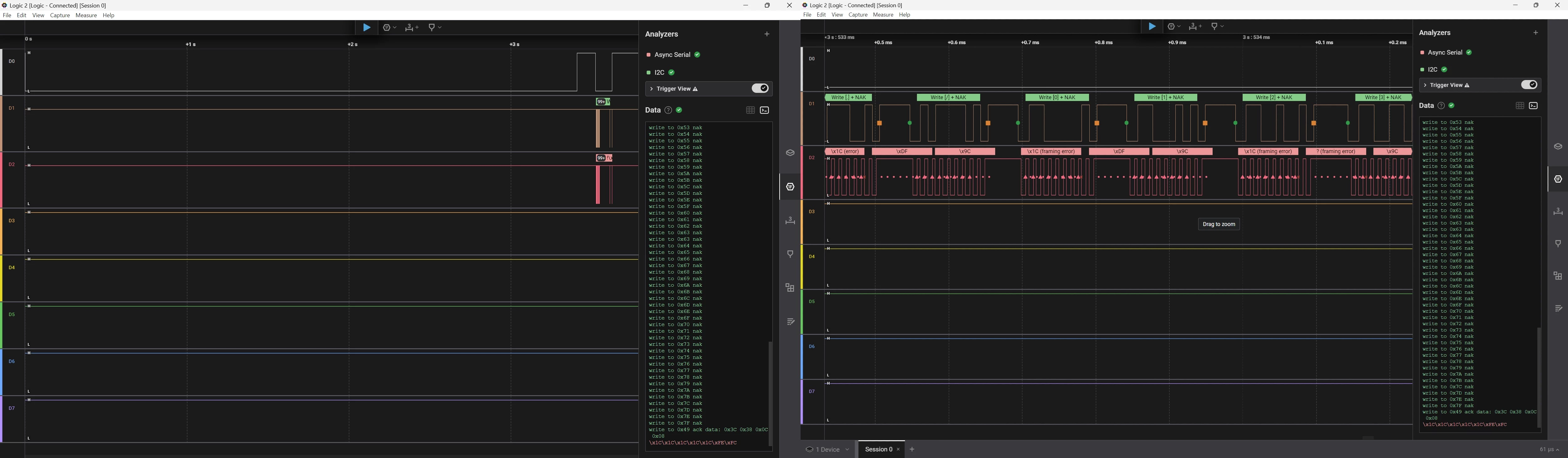

Hello!
I have a major and pretty dumb problem regarding my communication between a RX2004A LCD (Documentation if needed) and a custom board with a STM32U535RET6 chipset. I'm just trying to print any message on the display. The problem is that the display's reset pin is low active, so I'm trying to pull it up while sending the message, and the let it pull down again. The exact opposite happens, the message is sent in the time interval when the reset pin is pulled down, resetting the display while I'm trying to communicate.
I have attached down below the scripts (lcd_i2c.h being here, since I can't attach more than 3 files) that I'm using and some screenshots that illustrate the problem. I'm apologizing in advance if I chose the wrong board to post this on, or if this issue was already solved. I'm genuinely at the end of the line at this moment.
So make the pin high at the start of your program and leave it alone. Your code sets it low (i.e. RESET) at initialization, I don't see any code which makes it high.

Managed to pull the RESET pin high. My problem now is that almost every message is a framing error on SCL.
\x1C\x1C\x1C\x1C\x1C\xFE\x1C\x1C\x1C\x1C\x1C\xFEwrite to 0x49 ack data: 0x4D 0x49 0x8D 0x89
