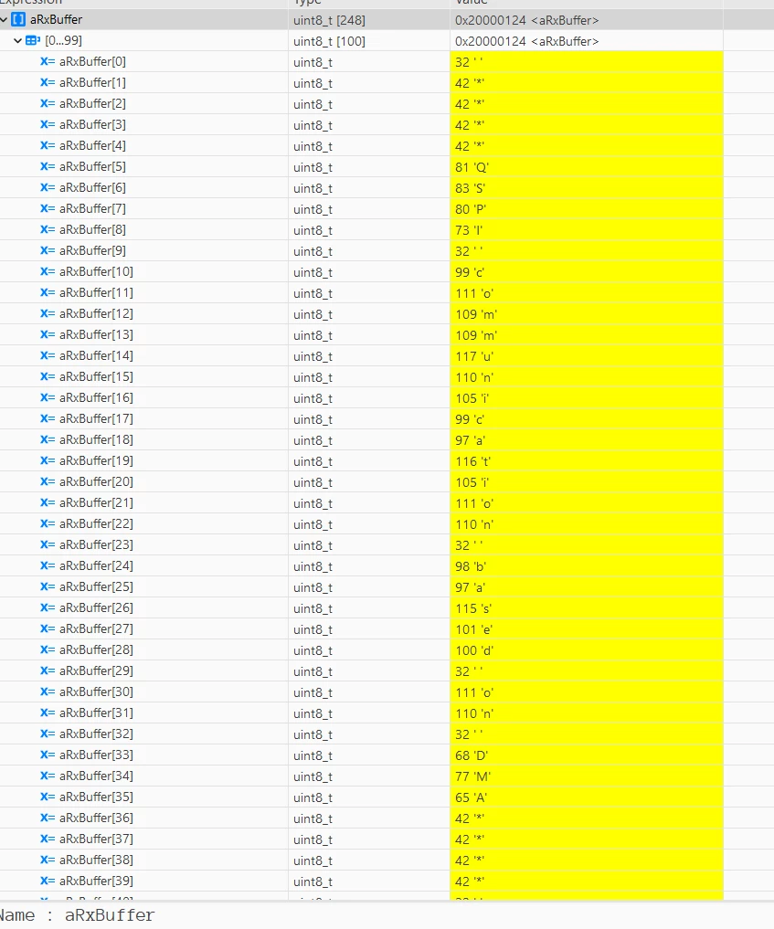

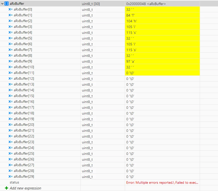

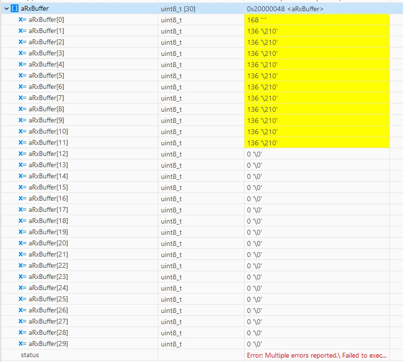

To investigate the erase phase further, I added a read operation just after to check if I get 0xFF values. Here's the first surprise: that's not the case (See attached image A). I can only read about 12 values, and they're all equal to 136? Even more surprising is that the write and next read kind of work on those addresses marked as 136 (See attached image B), which is weird...
A:
_legacyfs_online_stmicro_images_0693W00000dDKzCQAW.png B:
_legacyfs_online_stmicro_images_0693W00000dDL4zQAG.pngThis suggests an error in the erase phase, but then came the funny part:

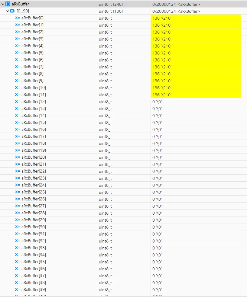

I tried the working row again, using the same process. After the erase, the read operation gave me similar results (See attached image C), but after writing and reading back, I have all the data (See attached image D, trust me, all the rows are complete and correct). This makes no sense to me, as it indicates that the erase is working correctly.
C:
_legacyfs_online_stmicro_images_0693W00000dDL4QQAW.png D:
_legacyfs_online_stmicro_images_0693W00000dDL4VQAW.pngI am running out of ideas here.
