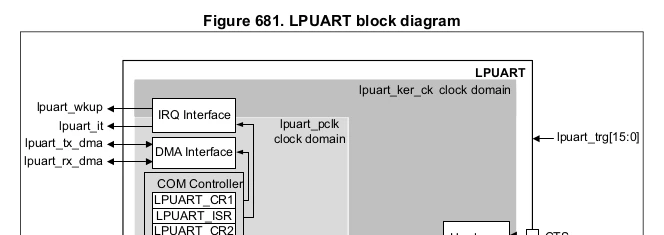

Hello.
I'm trying to wakeup the STM32U5 controller (U575ZI Nucleo board) when a byte is received using the LPUART.
I'm using the LSE clock for the LPUART. Without entering the stop mode, the LPUART interrupt is triggered whenever a byte is received. This is working fine.
But when I enter the stop mode, I'm not able to wakeup the controller with the LPUART. Using the Userbutton as wakeup source is working.
The reference manual shows the "lpuart_wkup" output signal in the block diagram. But there is now further description about this signal and how it is enabled. Other STM32 controllers (like the STM32L4) have a dedicated WUFIE interrupt bit which can be enabled.
How do I enable the wakeup signal for the LPUART on STM32U5 controllers. Can you help me please.

Hi @andreas23​,
what stop mode are you using? In RM0456 table 89 you can see that LPUART can only wake the MCU from Stop1 and Stop2, not from Stop3.

I tried Stop0, Stop1 and Stop2. But I wasn't able to exit any of these stop modes with the LPUART.

I see. Did you enable the UESM bit in the CR1?

Yes I did enable the UESM bit in the CR1 register. Is this bit responsible for the lpuart_wkup line of the block diagram?
Do I need to configure something else to enable the lpuart_wkup line. Is there something I have to enable in the PWR module? To use the user button for the wakeup I had to enable the wakeup pin. Is there something similar for the LPUART?

Yes I did. The CR1 register is set to 0x2F (RXNEIE, TE, RE, UESM, UE). I know it is hard for you to help. Maybe, you have an example which demonstrates the wakeup from stop mode with the LPUART?
