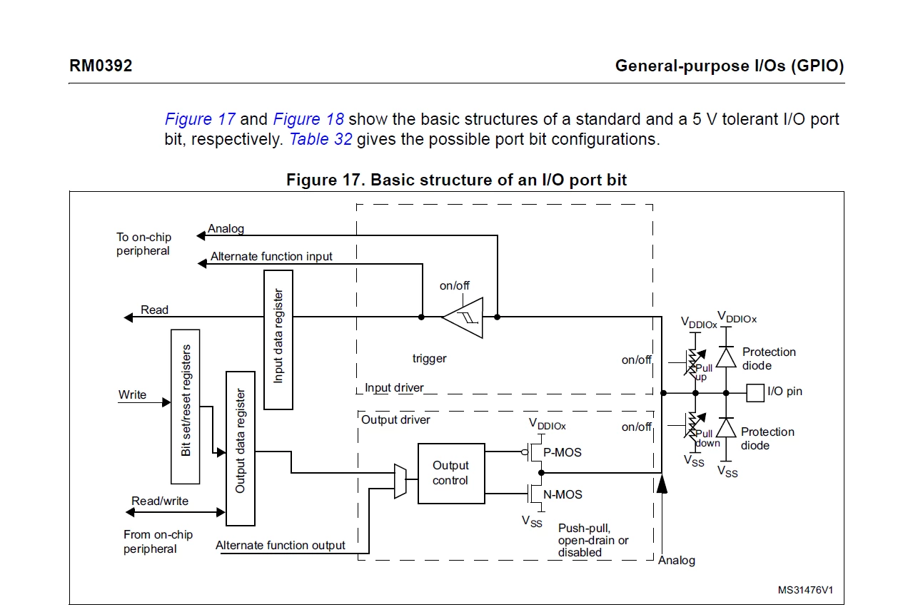

I set several unused pins in stm32u5 to floating as hardware and set them to low output by pushpull for ESD protection.
The microcontroller was heating up abnormally when I looked at it with a thermo camera, and I found that the current consumption of VDDA was mysteriously high, and the current consumption changed within a few seconds.
When the unused pins were set to analog input, the current consumption of VDDA dropped by about 30 mA, and the current consumption became the same all the time.
It is very strange to me that the VDDA current consumption increases instead of the VDD current consumption increasing.
Is there any possible cause for this?

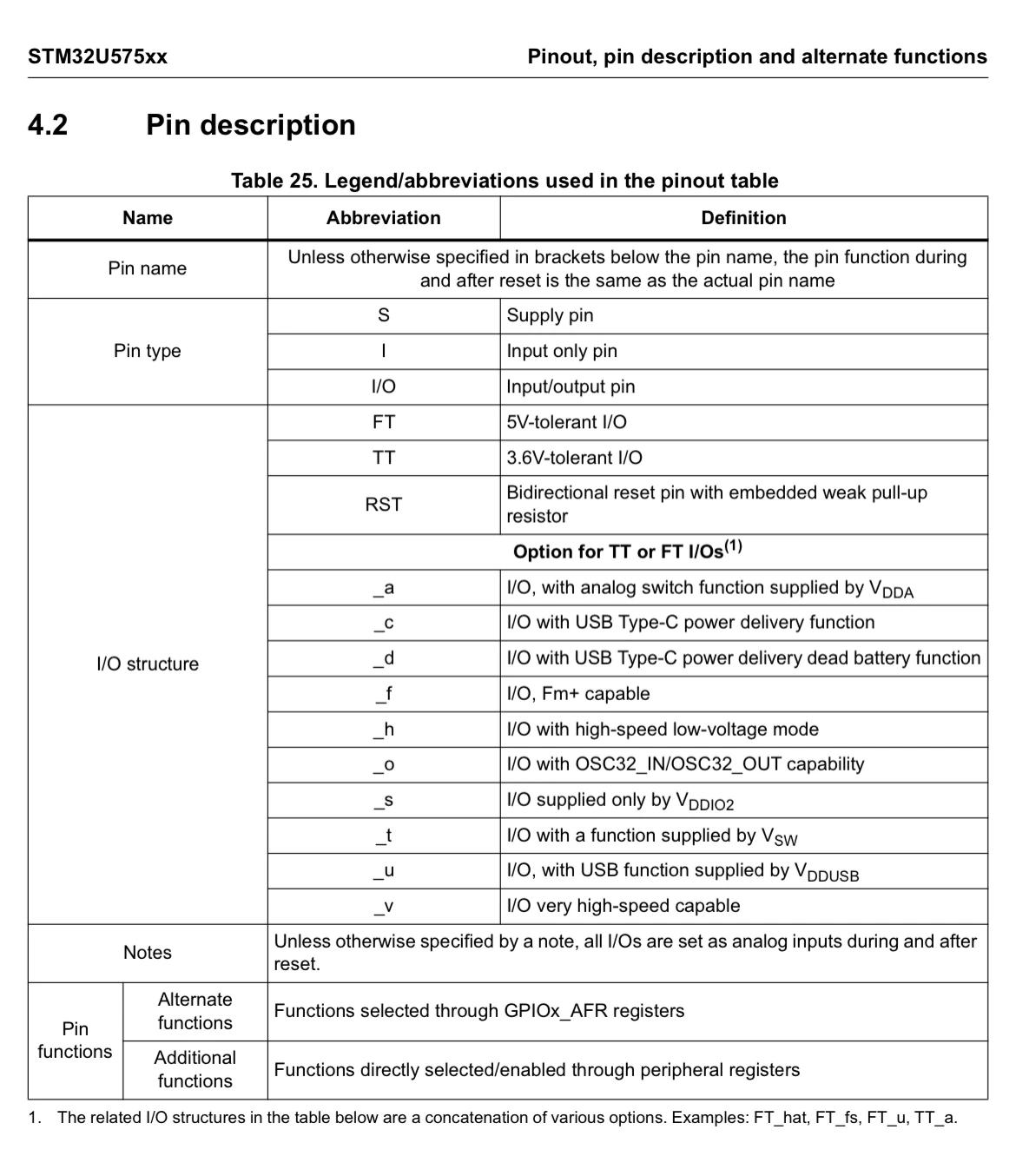

To debug this extra consumption, please provide the package / part number / PCB and also the firmware. Most probably a conflict either in PCB or software. Here are the I/O types - the ones with _à are connected to VDDA . Hope it helps you

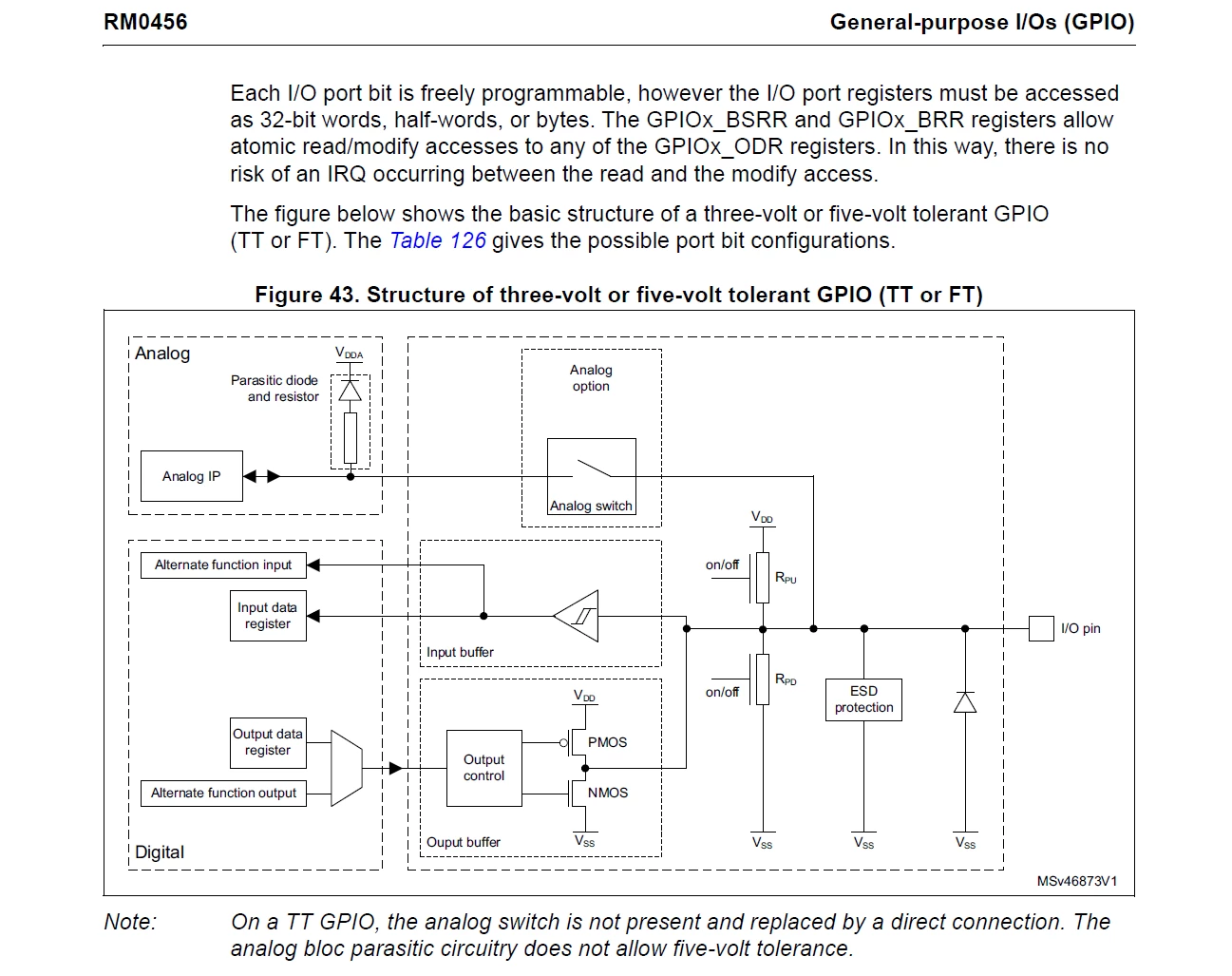

I am not familiar with analog switch circuits,
If there is an analog switch, does the current flow from VDDA to GND when the PushPull setting is set to Low output?
From the schematic in the reference manual, I thought that even if there is an analog switch, the current consumption of VDDA would not be abnormally high due to the VDD port setting.

However, I am wondering why the current consumption of VDDA has increased by more than 30mA, although I can understand if the current consumption of VDD is increased by this setting.
I would like to know what logic is causing this phenomenon.
