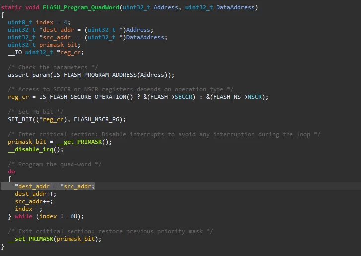

But when I call the HAL_FLASH_Program, I am getting a hardfault at this point, because I am trying to write to write to the address calculated above:

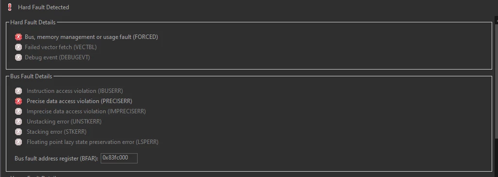

After erasing, can you read from 0x83fc000 and does it show all 0xFFs? Can you write to that location using STM32CubeProgrammer? No MPU settings or option byte settings preventing access?
What is the nature of the hard fault? There's a hard fault analyzer window (Window -> Show View -> Fault Analyzer) which can shed more light.
July 25, 2024
From the Fault Analyzer I am getting this:
Does this mean that I am not supposed to write directly to that address?

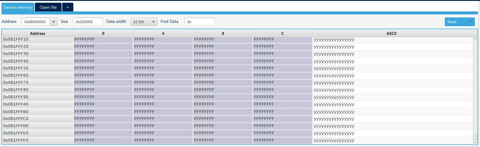

While testing with the Programmer I am observing something strange:
From the programmer I see this info for my device:
From this I assume that my device has 4MB of Flash.
If I perform a full erase all of the Flash should be FFFFs.
If I attempt to read the first 2MB only, like this:
I see indeed FFFFs everywhere.

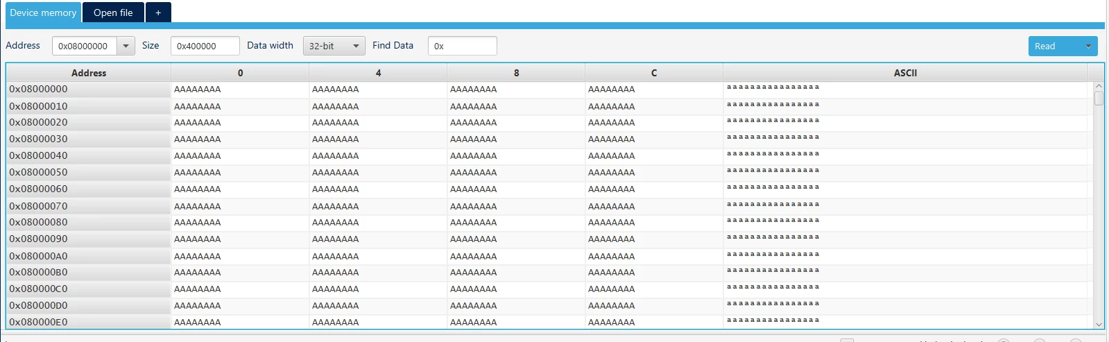

When I try to read all 4MB, like this:
I see AAAAs, which I am not sure what this means. I am not getting any warning that I am attempting to read past the size of the flash or anything like that.

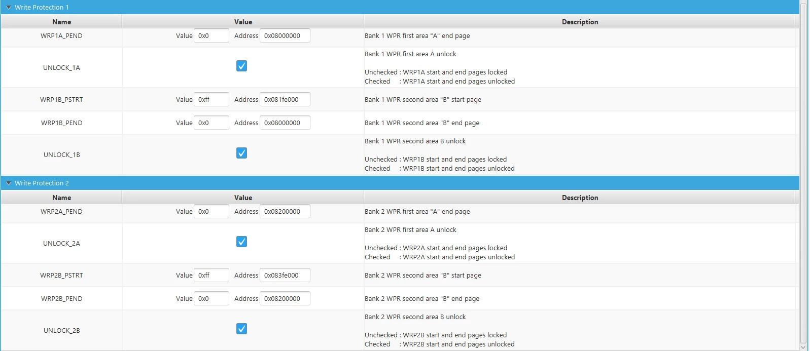

The option bytes as read from the Programmer look like this:
In the user configuration OB I see this option:
Not sure what does it mean for my case though. I tried to unset it and run the code with the same results
