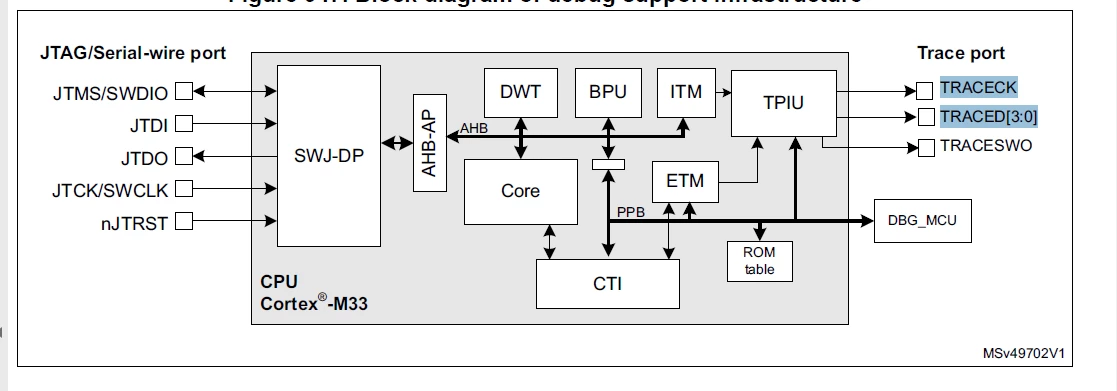

I trying to figure out what the maximum frequency is for the TRACECLK  stm32u5A9.
I found this post for the stm32h5
https://community.st.com/t5/stm32-mcus-products/traceclk-freq-in-stm32h5/td-p/604127
does the same apply for stm32u5 were can i in that case find this information for stm32u5?
Are there any pcb layout guidlines for
TRACECK

TRACECLK is connected to SYSCLK/2.
Please note that GPIO AC characteristics must be respected - high capacitive load or low voltage may not allow maximum speed of the TRACECLK signal.

And length from STM32U5 to Tracer will be aproximately 25 cm including the Segger cable.
Please advise if any line buffers are needed.
FNiel.1
January 22, 2026
I'm the hardware architect on this design. We are matching the impedance of the lines to the tracer connector to be 80Ohm. I assume that that fits the STM32 U5 drive impedance fairly well as this is the impedance of the Segger IDC cable?
We are also matching length as much as possible as per the Segger layout recomendations.
