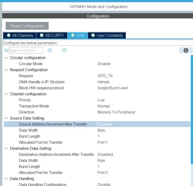

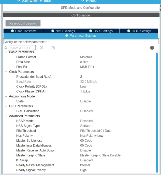

STM32U5 SPI with GPDMA: Unable to transmit more than ~1024 bytes
  • March 27, 2026
  • 1 reply
  • 247 views
(HAL_SPI_Transmit_DMA works partially, HAL_DMA_Start_IT not working)
I’m working with an STM32U5 MCU using SPI3 with GPDMA to drive an ILI9341 display. I’m trying to transmit a larger buffer (~23040 bytes), but display only receives about 1024 bytes, and goes into HAL_SPI_STATE_BUSY_TX forever.
Function used: HAL_SPI_Transmit_DMA()
Configs:
Thanks in advance !

Hello rutaz
Please verify the following three points to identify the root cause:
  1. Test a smaller, but greater than 1024, length (for example, 4096 bytes).
    • If the transfer always stops at approximately 1024 bytes, this suggests a configuration limit, such as burst, width, or interrupt settings.
  2. Check the remaining items count (BNDTR or CBR1, depending on the sub-family).
    • If the value is zero, the DMA considers the transfer complete, but the interrupt or callback is not executed.
    • If the value is nonzero, the DMA is stuck during the transfer, which indicates a configuration or overrun issue.
  3. Temporarily enable DMA error interrupts and add breakpoints in the HAL_DMA_ErrorCallback() function.
Best regards
