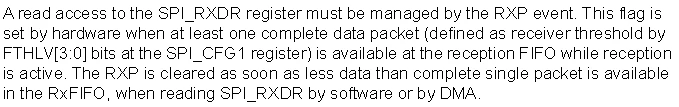

Hello, this is a general question for my understanding.
when I single stepped* through my SPI code, I encountered some unexpected behavior. But when I run over the code, it worked as expected.
*During this time, I had the peripheral SPI view opened.
So my question is, when the debugger updates the view, e.g. by showing me the content of the SPI_RXDR register in the peripheral view, will this already have an effect on the SPI HW, like when I read the SPI_RXDR with SW ?
Or can the debugger read the registers somehow different ?
(A read to SPI_RXDR will have effect to RXFIFO and Rx-Flags)
Yes, this reads RXDR which clears the RX buffer.
No, the debugger uses the same reading mechanism as the cpu and has the same effects on the flags.
@FKaes.1 this applies in general to any & all registers.

Hi, just to confirm it, I checked with SPI view open and closed. And the behavior was like explained. With open SPI view, I wasn't able to step over my code (because the RX flags were changed, when the debugger read and display the SPI register). But with closed SPI view, I was able to step over the SPI RX code.
