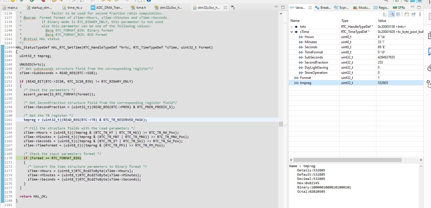

I am trying to get the RTC to work on the STM32U5 Nucleo board.
But when I read out the time I sometimes get a second and minute value that is more than 59. Any ideas as to how that happens?
I have checked that it is not because I write a higher value to the register.
I use LSI to run the RTC.

waclawek.jan
November 10, 2021
> RTC_FORMAT_BCD
I don't use Cube, but it appears that this requires the individual struct fields to have in BCD format.
Similarly, on the screenshot, if you read out time and use RTC_FORMAT_BCD, individual fields will be BCD, i.e. minutes = 33(decimal) = 0x21 (BCD); seconds = 69 (decimal) = 0x45 (BCD). That matches value read from the RTC->TR register, stored in tmpreg: it's 08:21:45.
MM..1
November 10, 2021
Little mistake Jan convert decimal values to hex valus 33 = 0x21 , but to BCD is 33 = 0x33 ... then values for format BCD is value bigger as binary for >9...
