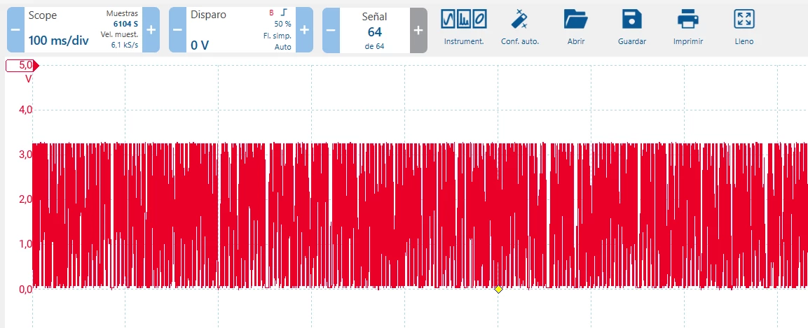

Hello everyone,
I am currently attempting to convert PDM data (from a MEMS CMM-4030DT-26354) to PCM data using the libPDMFilter_CM7_IAR_wc32 provided by STM32Cube. However, the results I am obtaining are not as expected. I am expecting a 1000 Hz sine wave tone, but instead, I am getting what appears to be noise (refer to the attached image). It is important to note that the PCM data is being sent to a DAC, which is set to a frequency of approximately 16 kHz.

I believe the issue lies with the library. It is unusual that a PDM value of 0 would result in a PCM value of 32768. I have the following questions:
  1. Why does AUDIO_IN_PDMToPCM only fill 16 values in audioPcmBuf? Shouldn't it fill the entire array?
  2. Why am I seeing a lot of noise? Isn't the library supposed to act as a low-pass filter?
  3. Am I setting something incorrectly, or is the library not compatible with U5?
I look forward to your reply.

Dear @eduarm ,
I’m not sure it will help, but it seems you are using this pre-compiled library “libPDMFilter_CM7_IAR_wc32” which is compiled for Cortex-M7 Core which is present in our STM32F7 and H7 series with IAR compiler.
U5 has Cortex-M33 core , so may be it is incompatible. I would suggest to check with M4.
