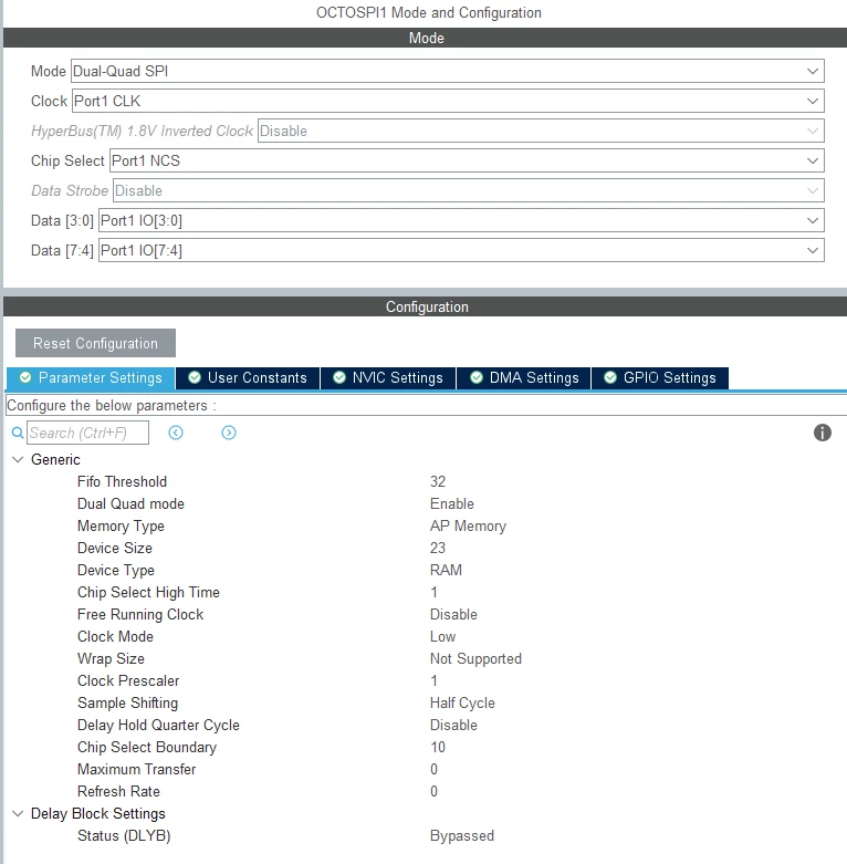

I'm experiencing an unexplained bus fault when the MCU writes to unaligned (not aligned to 32-bit) addresses in the OSPI memory region. I've written a minimal implementation that shows where the issue occurs. See below.
I'm using the STM32U585 with two IS66WVS4M8BLL quad SPI modules. The OctoSPI peripheral is configured in Dual-Quad Mode. See the image for the settings as configured in STM32CubeMX. I use memory mapped mode. I've enabled DQS for writes as per 2.6.1 of the errata. I've tried different MPU cache configurations for this area: no MPU, MPU_DEVICE_nGnRnE, and (MPU_WRITE_THROUGH | MPU_NON_TRANSIENT | MPU_W_ALLOCATE | MPU_R_ALLOCATE).

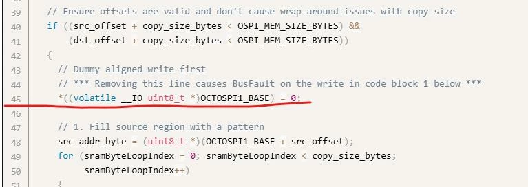

 // Test 2: Unaligned Copy within SRAM
 // *** Here things are not well ***
 volatile __IO uint8_t *src_addr_byte;
 volatile __IO uint8_t *dst_addr_byte;
 volatile uint8_t test_pattern_byte;
 const uint32_t copy_size_bytes = 512; // Size of data to copy
 // Ensure source and destination are unaligned and distinct
 const uint32_t src_offset = 1; // Unaligned source start
 const uint32_t dst_offset =
 (OSPI_MEM_SIZE_BYTES / 2) + 3; // Unaligned destination start
 // Ensure offsets are valid and don't cause wrap-around issues with copy size
 if ((src_offset + copy_size_bytes < OSPI_MEM_SIZE_BYTES) &&
 (dst_offset + copy_size_bytes < OSPI_MEM_SIZE_BYTES))
 // Dummy aligned write first
 // *** Removing this line causes BusFault on the write in code block 1 below ***
 *((volatile __IO uint8_t *)OCTOSPI1_BASE) = 0;

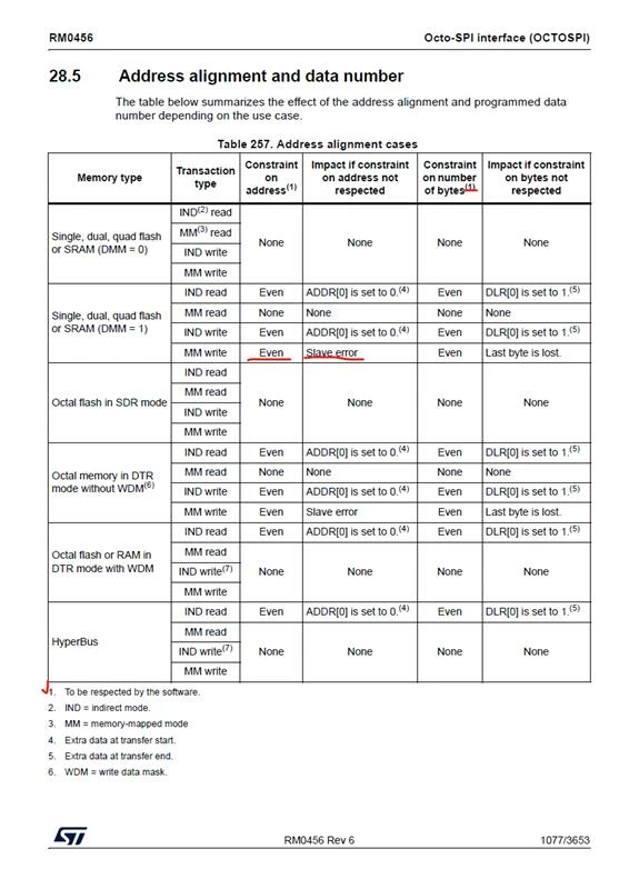

Alex - APMemoryBest answer
Apr 7, 2025 3:14 PM UTC
Not sure if this helps.
It seems there are something done wrong on STM32 MCU. befow domments from our team:
1, Since Test 1 is good, basic read/write on dual-quad SPI configuration is working.  Effectively, it's OPI with DMM = 1 (dual-memory mode).
2. According to the data alignment constraints, it becomes halfword-addressable memory, not byte-addressable.
3. Test 2 doesn't seem to honor the constraints, as it touches the odd address in the very first PSRAM read. I suspect it is the MCU cache that shadows the unaligned access in Test 1, where the cache is always filled by the previous aligned access. In another words, the cache absorbs the unaligned accesses, such the PSRAM sees no accesses with odd addresses. Once this assumption is broken (as cache is disabled or access an odd-address when cache is cold), there will be unaligned access to PSRAM.
Relevant constraints:
(default write-through) MCU cache is preheated by write:
10 replies

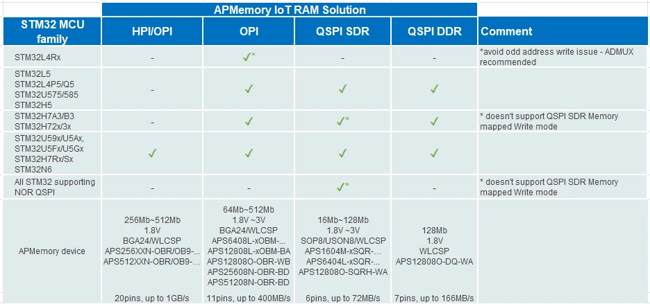

Alex - APMemory
Apr 7, 2025 9:15 AM UTC
You are right about dual quad, this should work
Let me share overview of supported device/SoC
https://wiki.st.com/stm32mcu/index.php?title=Introduction_to_external_serial_memories_XSPI_interoperability_for_STM32&oldid=63515
 APMemory IoT RAM Solution
STM32 MCU familyHPI/OPIOPIQSPI SDRQSPI DDR
STM32L4Rx-✓*--
STM32L5
STM32L4P5/Q5
STM32U575/585
STM32H5
STM32H7A3/B3
STM32H72x/3x
STM32U59x/U5Ax, STM32U5Fx/U5Gx
STM32H7Rx/Sx
STM32N6
All STM32 supporting NOR QSPI--✓*-
APMemory device256Mb~512Mb
1.8V
BGA24/WLCSP
APS256XXN-OBR/OB9-...
APS512XXN-OBR/OB9-…
64Mb~512Mb
1.8V ~3V
BGA24/WLCSP
APS6408L-xOBM-...
APS12808L-xOBM-BA
APS12808O-OBR-WB
APS25608N-OBR-BD
APS51208N-OBR-BD
16Mb~128Mb
1.8V ~3V
SOP8/USON8/WLCSP
APS1604M-xSQR-…
APS6404L-xSQR-...
APS12808O-SQRH-WA
128Mb
1.8V
WLCSP
APS12808O-DQ-WA
20pins, up to 1GB/s11pins, up to 400MB/s6pins, up to 72MB/s7pins, up to 166MB/s

burn_
burn_Author
Apr 9, 2025 8:34 AM UTC
Hi @Alex - APMemory ,
Thanks for reaching out to your team. Your description of the problem makes perfect sense. The implication is that I'm also likely loosing data when an odd number of bytes is written.
Another helpful clarification is that it is halfword-addressable memory (I assumed word-addressable would be the solution).
I'll construct an example with caching disabled and see if test 1 then also fails.
