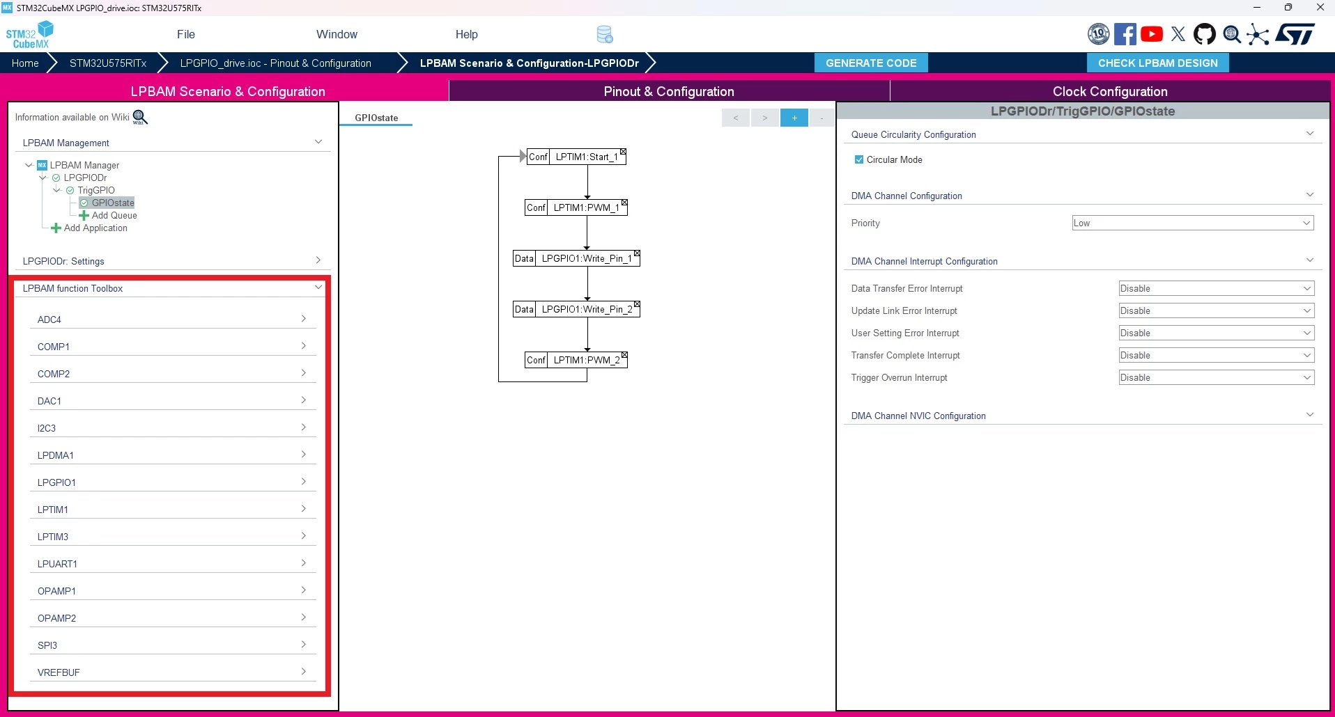

coppercrimp
Jun 19, 2025 5:45 PM UTC
Hi Sarra,
I'm also using version 6.14 and can see the settings screen you shared. However, I was specifically referring to the "LPBAM Scenario & Configuration" tab and the "LPBAM function toolbox" (see screenshot). Every LPBAM example I've seen instructs you to build a scenario queue by selecting peripherals in the LPBAM function toolbox. But the ADF and MDF peripherals are missing from this toolbox
