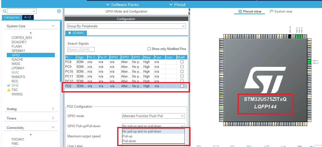

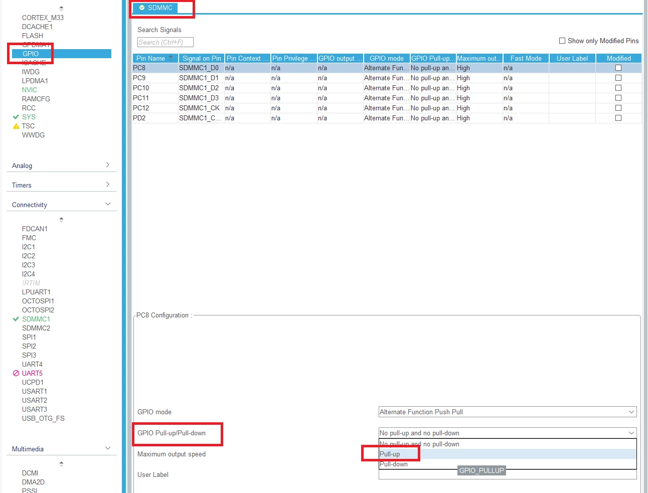

I'm not reproducing the issue on STM32CubeMx version 6.12.1:
Are you using the latest version?

Meanwhile to answer your remark regarding how to configure pull-up/down resistors in CubeMx on already configured pins for peripherals, you need to go to GPIO -> SDMMC and select what GPIO you need to set the internal resistor as indicated in the following screenshot:

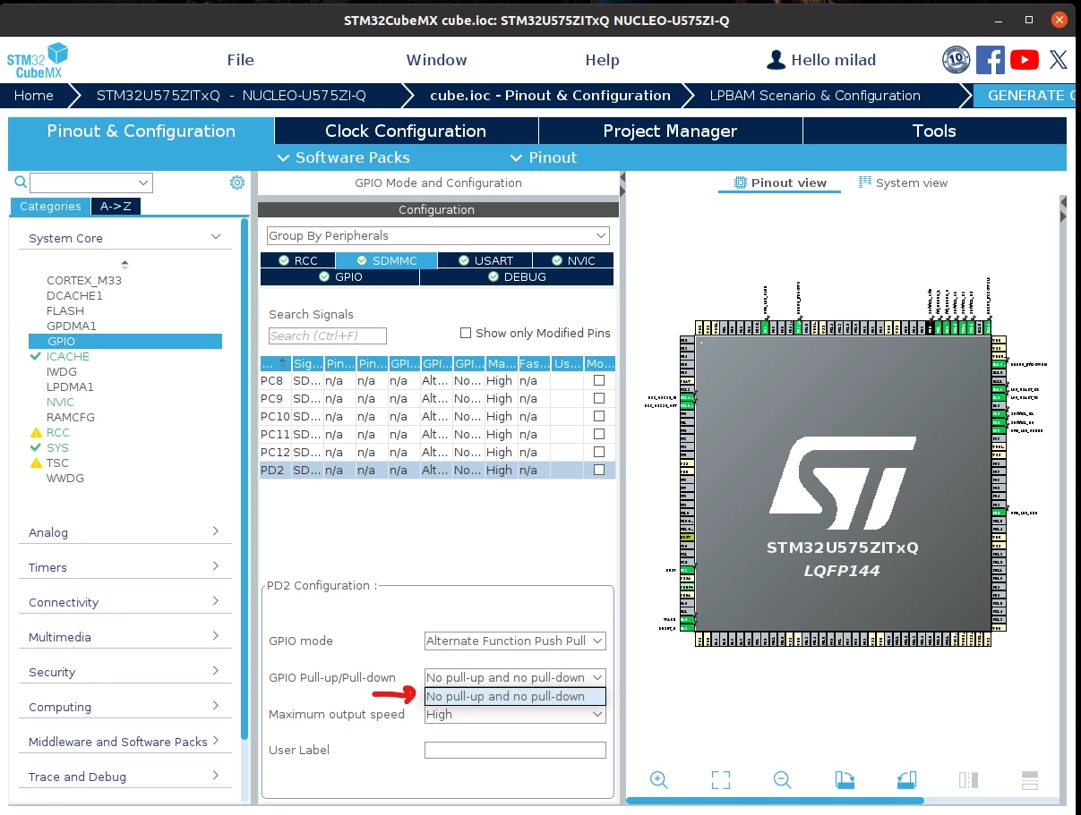

I understand that the recommendations ask for external pull-up. however for our use case we would like to see if the internal pull up on cmd line can work.
regarding the screen shot that you shared, is it STM32U5 series? because I can't select pull-up there (my screen shot is for CMD line but that's the same for other SDIO pins as well):
Kind regards.

November 7, 2024

Hi.
No. I'm using 6.11.1-RC2.
Ok. if it's showing up in later versions of CubeMx, it proves that probably there's no hardware limit for turning pull resistors.
