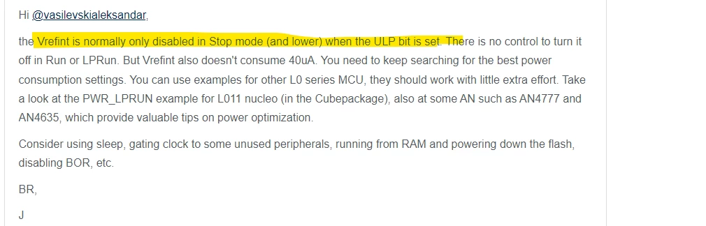

When the MCU goes into stop mode 2, the VREFINT keeps drawing current. Is there a control register to turn off VREFINT when the MCU goes into stop mode 2

I found a clue in the post below, but I have no idea what the register name is, and I couldn't find it in the STM32U575 manual.
https://community.st.com/t5/stm32-mcus-products/stm32l010k8-on-off-adc-vrefint-in-low-power-run-mode/td-p/571769
