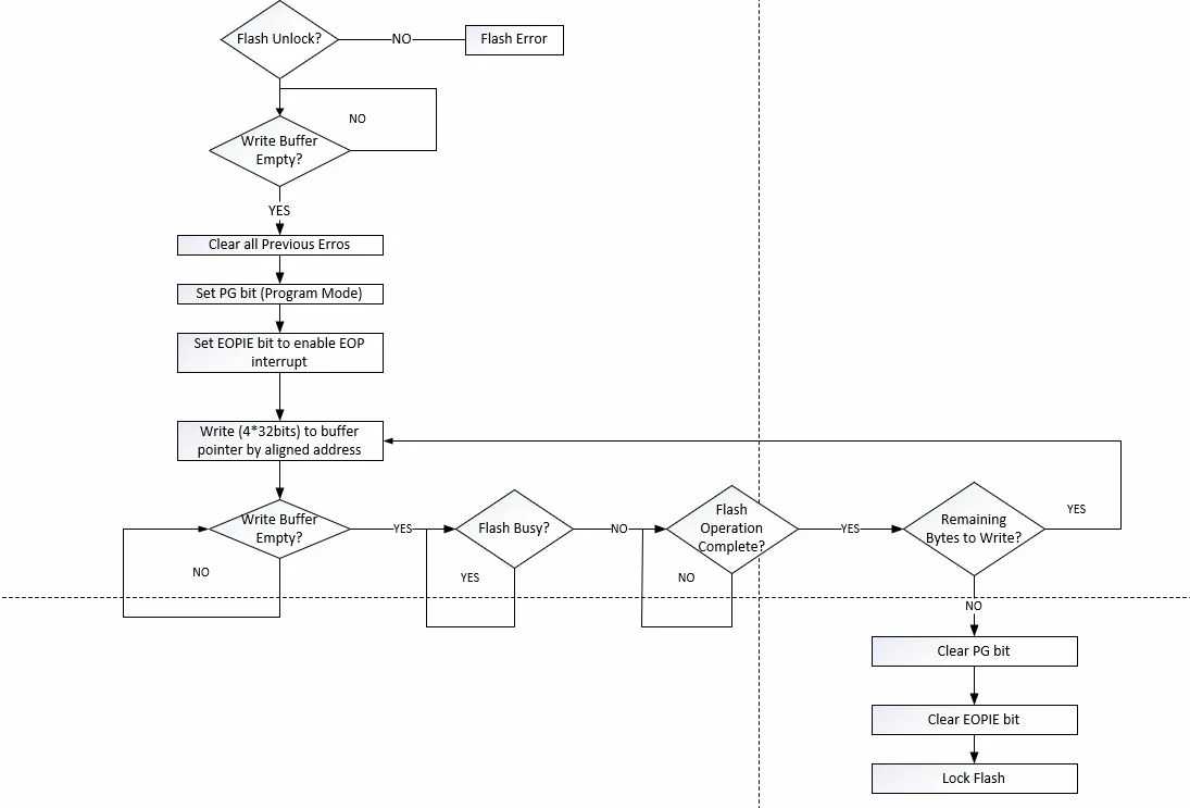

Flash word is written to aligned address and flash page is erased before it is written. I may not be able to share code. I have attached is the flow chart of the flash driver implemented.

Flow chart doesn't make a ton of sense.
If write buffer is empty to start, it's stuck in an infinite loop. Why is EOPIE enabled at all? Handling the IRQ doesn't seem to be a part of the process. If buffer doesn't have an integer number of flash words, it's unclear what happens. Maybe "write buffer" is shorthand for something other than bytes left to write to flash.
Ultimately, you'll have to do some debugging on your particular code if you can't show it here. You can also use HAL code that achieves the same goal. It's unlikely that the process outlined in the RM has issues and there isn't much more to go on here.
