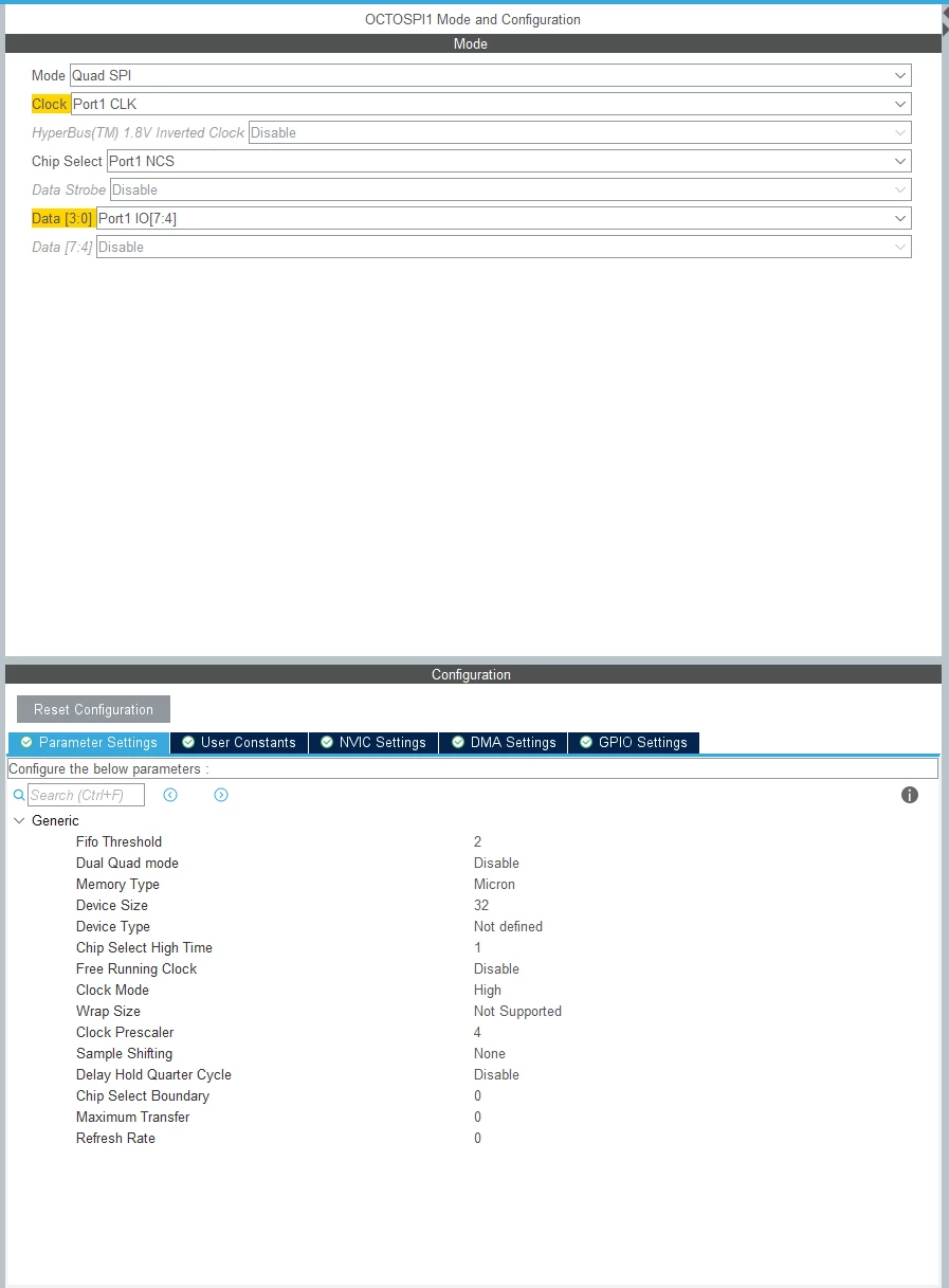

I notice the delay block doesn't seem to be configurable for the OSPI peripheral in QSPI mode. Does any one know if it is still possible to use the delay block with a QSPI clock? I've tried coding the delay block a few different ways but it doesn't seem to work.

EvoFrankAuthor
April 3, 2024
Hi All, Sorry for the delay in responding.
To clarify I'm using a U585.
--> Are you using STM32CubeMx to generate code?
I do not have the option of enabling the delay block in CubeMX if I configure the OSPI peripheral to work in QSPI mode. This makes me think that perhaps one cannot use the delay block in QSPI mode, see screenshot below:
I can manually modify the generated code for the OSPI peripheral from:
hospi1.Init.DelayBlockBypass = HAL_OSPI_DELAY_BLOCK_BYPASSED;
to
hospi1.Init.DelayBlockBypass = HAL_OSPI_DELAY_BLOCK_USED;
However, it seems that modifying OspiDLYBCfg.Units and OspiDLYBCfg.Phase doesn't seem to make any difference to whether data is Tx/Rx'd correctly at a given clock frequency.

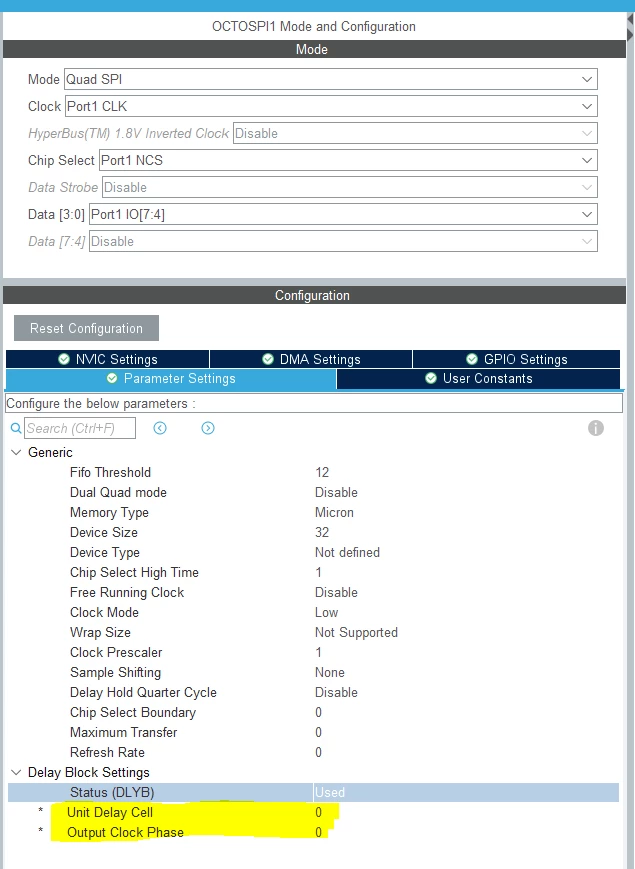

KDJEM.1
October 7, 2024
Hi @EvoFrank ,
I apologize for any inconvenience. Now, the Delay block configuration issue using STM32CubeMx toolchain is fixed in STM32CubeMX V6.12.0.
I think  DLYB_OSPI_PSRAM_ExhaustiveTuning is interesting example.
Thank you.
