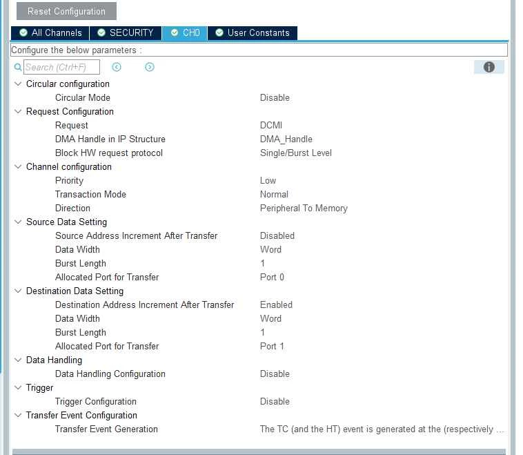

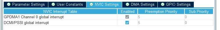

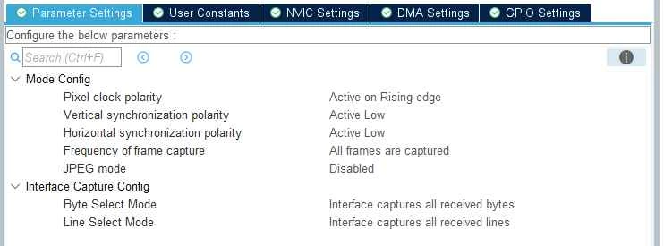

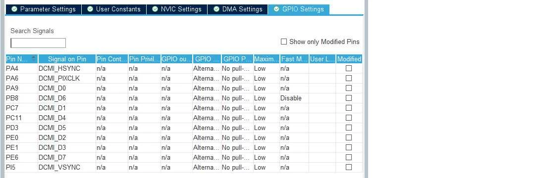

    We have developed an image capturing application successfully based on STM32H7xxxx and OV7725 camera. We are now targeting to port the application to target STM32U5xxxx with the same camera. But it looks the DMA doesn't works as expected. The DCMI DMA complete callback is firing with no image data in the target buffer.
    Please guide us how to port the application from H7 to U5.
Best regards-
Shubhendu Bikash Banerjee
Attaching here snaps of the configurations we made so far.
DCMI GPIODCMI GPIO
DCMI NVICDCMI NVICDCMI parametersDCMI parametersGPDMA1 channelsGPDMA1 channelsGPDMA1 CH0GPDMA1 CH0GPDMA1 securityGPDMA1 security

Hello @shubhenduatadben ,
What is the DCMI_PIXCLK frequency? Could you please try reducing the clock frequency.
I recommend you to look at DCMI_ContinousCap_EmbeddedSynchMode example and precisely the DCMI_ContinousCap_EmbeddedSynchMode.ioc file and get inspired to check the DCMI and GPDMA configuration.
