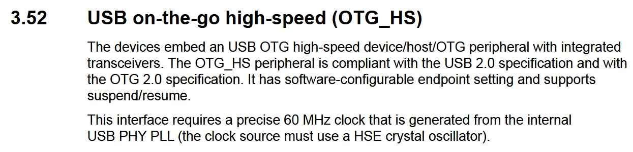

I have just hit the same issue. And it looks like it is a bug in STM32CubeMx configurator (it should throw an error if you try to use crystal-less on chips with USB HS).
I believe the crystal-less is only supported with STM32U5 FS chips (535/545/575/585). The chips which have the HS PHY (595/5A5/599/5A9) require an external crystal. The datasheet specifies that quite clearly:

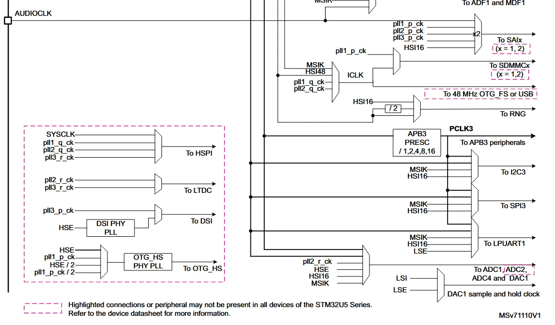

It is further detailed in the reference manual's RCC section:
The red-dashed lines show differences between FS and HS chips.
In order for crystal-less to work, the clock recovery system (CRS) must be used which works only with the HSI48 oscillator. HSI48 can be selected as a source for the FS block, but the HS block requires a PLL/HSE clock - HSI48 is not available there.
