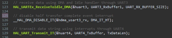

Set up a simple program to transmit 8-bit data out one UART using interrupts and receive it in another UART using DMA.

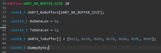

Variables used:

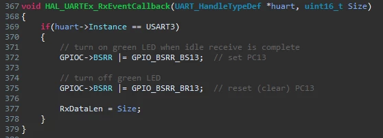

The UARTEx handler toggles the green LED when the Idle event is detected.

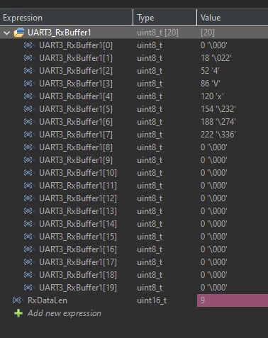

The program works, but the RxDataLen size is 9 bytes, not 8 and the first buffer byte is always 0.  The remaining bytes are correct per my predefined array.  If I loop this sequence, the results are always the same.

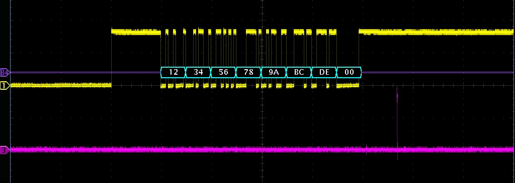

A scope screenshot clearly shows there isn't a leading 0x00 byte being sent.  Purple trace is the LED toggle on Idle.
I've tried adding delays between the DMA and transmit and it doesn't change the result.  If I read the USART3->RDR register before the HAL_UARTEx_ReceiveToIdle_DMA(), then it works correctly (8 bytes, UART3_RxBuffer1[0] = 0x12).  It doesn't seem like I should have to do that.
Is there a better way to fix this?
