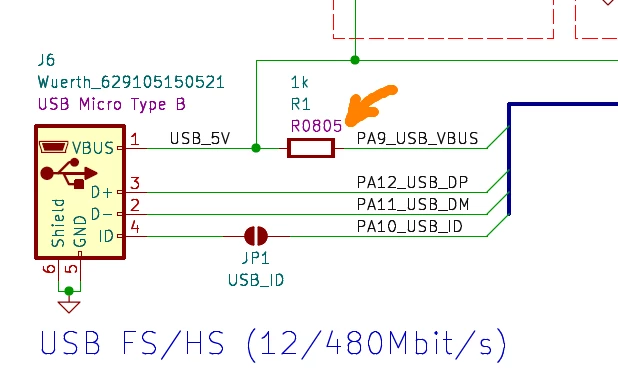

I use STM32U083RCT6 on (my own) simple development board powered by 3.3V (VDD=VDDA=3.3V). I am using small LCD display glass with 4x8 segments.

Killed processor
I am afraid that that the generated voltage is internaly limited by ESC circuit on GPIO. It does not withstand long. My processor has now broken GPIO PA9. It is somehow shortened inside. The PA9 pin now generates wrong voltages (instead of expected 4 levels, only 2 levels is generated).
VDD=3.3V VLCD=2.73V, LCD_FCR.CC=1, LCD_CR.BUFEN=1
PA10: 0V, 0.92V, 2.04V, 3.1V (more or less expected)
PA9: 2.56V, 3.72V (not expected)
After reset I can see 4.9V on pin PA9 (and high-Z on PC3=VLCD). LCD step-up convertor is not deactivated by reset signal. I think reset disables LCD_CR.BUFEN but does not stop step-up convertor.

You are absolutely right. The problem is in schematics. I thought that there is nothing but CPU and then I stared to think - thank to you. In short the problem is resistor from USB VBUS (+5V if plugged in) to PA9=LCD_COM1. Because development board is more or less universal the PA9 is connected to USB VBUS (VBUS sensing, USB_OTG_FS_VBUS for some processors) via resistor R1.
Resume:
be aware of USB_VBUS sensing connected to PA9 on universal development boards which is not compatible with LCD.

For a custom board, behaving oddly, might I strongly suggest you attach a schematic. You can redact sensitive parts as you wish, but show STM32 it's connectivity, especially power, regulation/supply, and LCD
