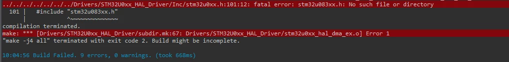

/../../Drivers/STM32U0xx_HAL_Driver/Inc/stm32u0xx.h:101:12: fatal error: stm32u083xx.h: No such file or directory
I have downloaded the drivers file as well but I can't find the file within that directory for stm32u83xx.h and was wondering if there's a way to still build the project without it? I did manually put the stm32u0xx.h file into the HAL_Driver directory because it looked like it was missing it but even with it included, it was still showing the error. I don't know where to look for the stm32u83xx.h because it's referenced in the stm32u0xx.h but not included in the drivers folder  (https://github.com/STMicroelectronics/stm32u0xx_hal_driver/tree/f949e9dd4d8509051e0e4fd34067a3cfc37fe089).

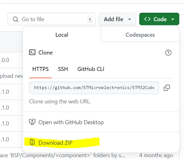

Have you downloaded the STM32CubeU0 as .ZIP file using this Command:
If so, the code will have some driver issue. The only way to guarantee that it will work is to Clone repository using the command:
git clone --recursive https://github.com/STMicroelectronics/STM32CubeU0.git
Or download it from the ST Website (on this link).

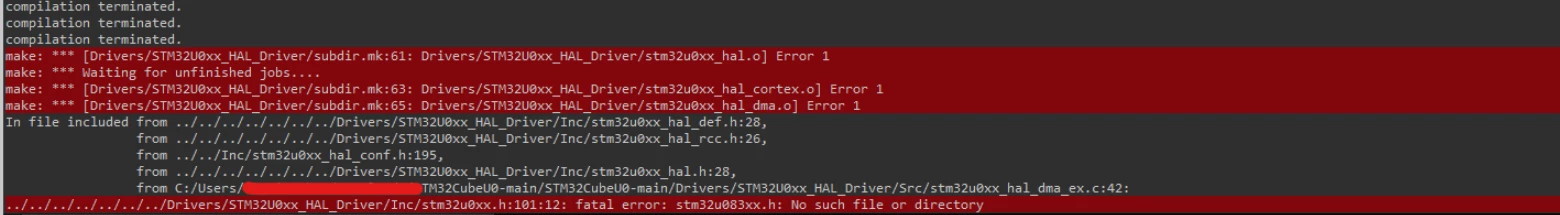

Here are the error messages I am getting
It's called somewhere from the default code from the Github example but I don't know where. I know the stm32u083xx.h doesn't exist in the driver include file path but I can't find online where to download the file either.

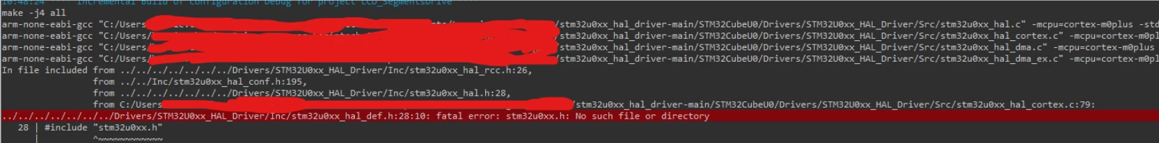

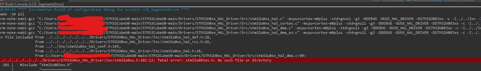

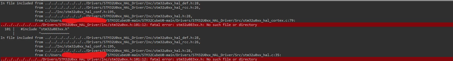

I've deleted the folders I had originally and then re-downloaded the files again using your suggestions. I'm still getting errors. stm32u0xx.h doesn't seem to exist in the folder by default.
I'm still getting errors when compiling on STM32CubeIDE
