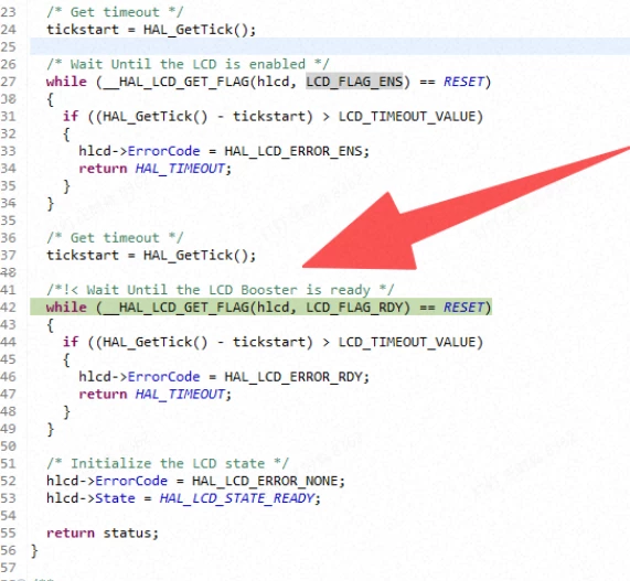

I'm using the LCD of the STM32U073K8, but the program failed to initialize the LCD. After checking, I found that the STM32U073K8 doesn't have the VLCD pin. Is the STM32U073K8 not compatible with the LCD peripheral? Or are there other settings?

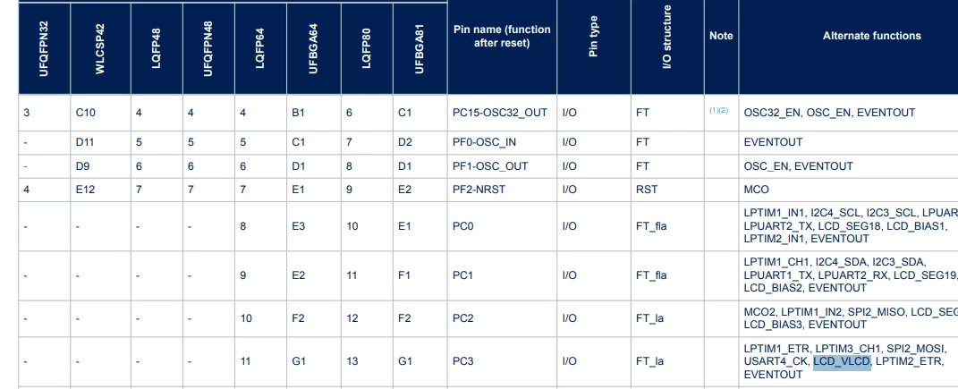

First of all I apologize for my late reply. I confirm that the LCD functionality is not guaranteed without proper VLCD connection.

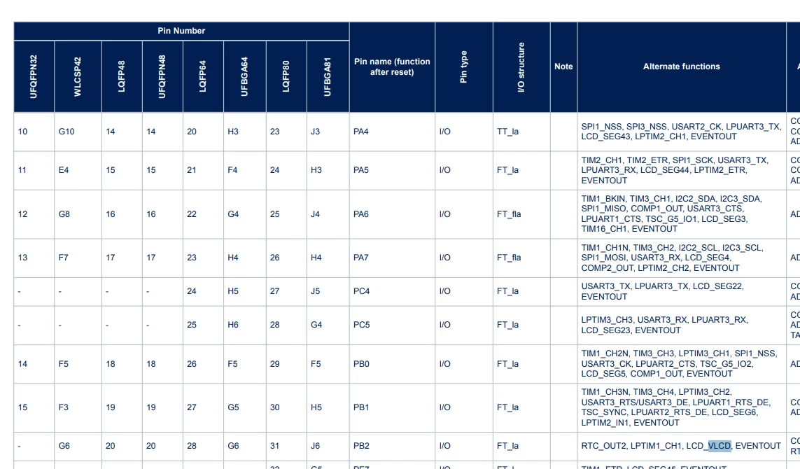

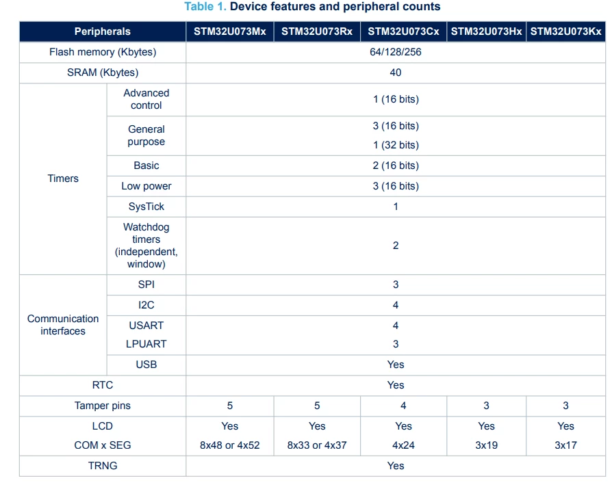

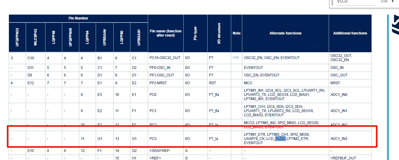

So 32 pin case has no Vlcd pin.
But if pin not present...no cap here possible.
So you picked the only case without vlcd pin.
Take the next one ...with vlcd pin.
