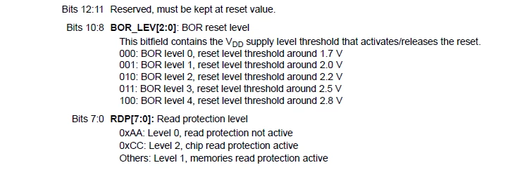

STM32U073 - FLASH_OPTR discrepancy in reference manual
There appears to be a discrepancy between the STM32U073 reference manual and the header file for the part.  Given that STM32CubeProg seems to agree with the header file, I'm inclined to think it's an error in the reference manual.
I'm looking at programming the brownout detection bits in the STM32U073.  If I look at stm32u073xx.h (STM32Cube FW_U0 v1.2), I see this:

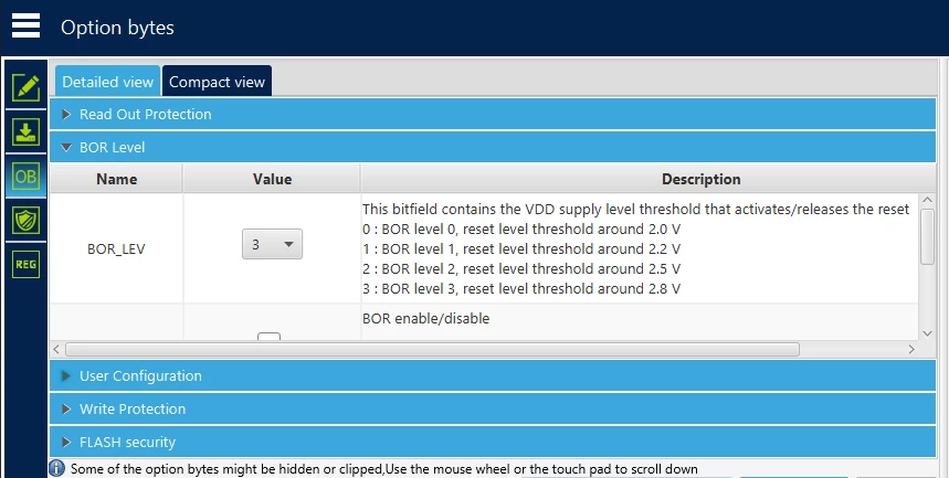

And if I connect a Nucleo-U083 and look at STM32CubeProg (v2.19), I see this:

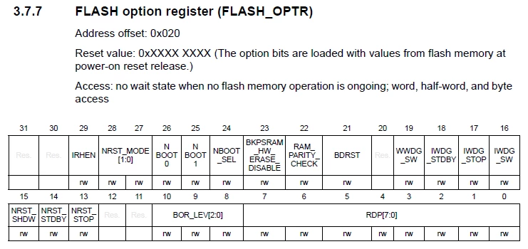

However, if I look in the STM32U0 reference manual (RM0503 Rev 2), I see this:
The header file and CubeProg suggest there are two bits (four levels) of BOR detection with a separate enable bit, but the reference manual suggests there are three bits of level with no separate enable.  I'm inclined to believe the header file and CubeProg.
Is this an error in the reference manual?

Actually, hold on a second... I think the reference manual AND CubeProg are both wrong, in different ways.

From these definitions here, I can infer that the U0 has two separate brown-out level settings, one for rising power, and one for falling power.  The reference manual doesn't mention any of this, and CubeProg only shows a single brownout reset level setting (BOR_LEV).
Do both the STM32U0 reference manual and CubeProg need to be fixed?
