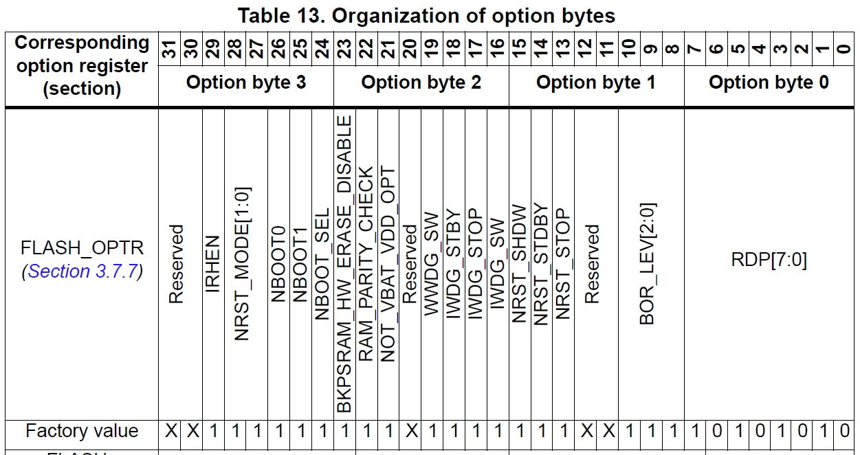

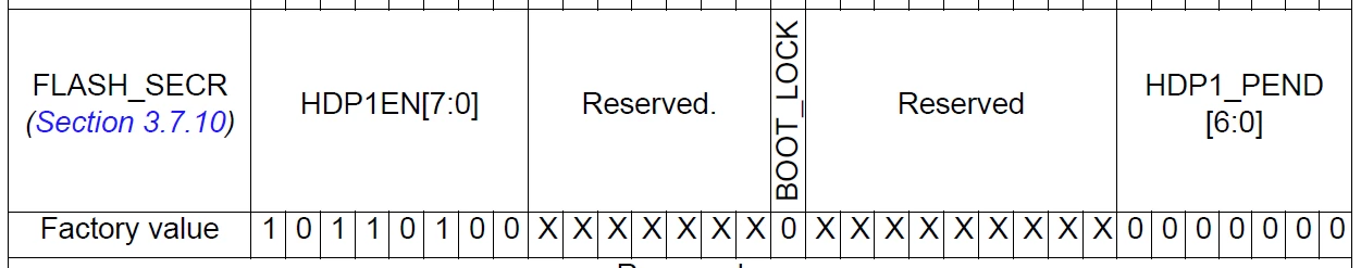

Here are the option bytes and their factory default values:
BOOT_LOCK, naturally, defaults to 0, so that's fine.  But all of the other bits default to 1, including nBOOT_SEL, which needs to be 0 to allow BOOT0 to do, well, anything.
Am I correct in that it's not possible to bootload a U083 device via I2C unless you've touched it at least once with a programmer and cleared the nBOOT_SEL bit?  (If so, that's extremely annoying for our rev. A prototype.)

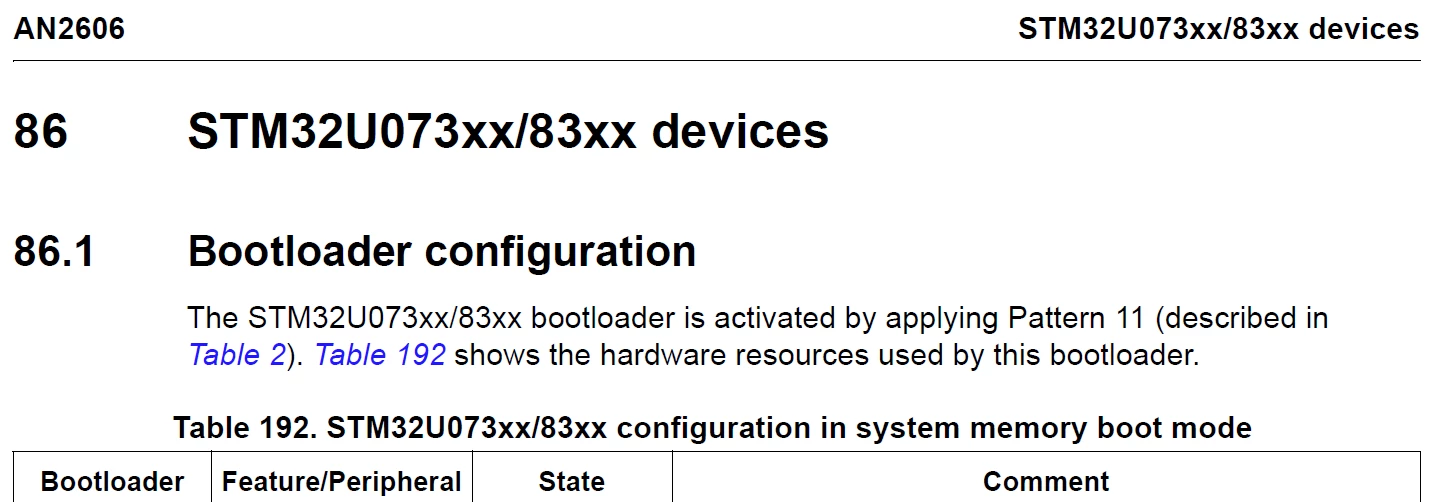

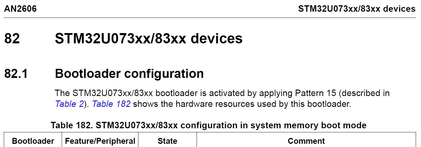

... those sneaky gits.  They updated the app note.
AN2606 revision 63/64 (I have a partial printed copy here):
AN2606 revision 65 (February 14, 2025):
Reading the revision notes, apparently this rates as "Minor text edits across the whole document".  However... I'm not convinced it was a correction.  If I chip erase my U083 Nucleo, put nBOOT_SEL back to 1 (as it would be from the factory), and then try to engage the bootloader, I still can't do it; I get NAKs on I2C.  If I set nBOOT_SEL to 0 and retry, I get the bootloader version just fine.
So I guess my question now is... was ST correct the first time, and the U083/U073 really is Pattern 15, with no allowance for empty flash?  Or am I still doing something wrong?  A chip erase via ST/LINK is all that's needed to qualify as "empty flash", yes?

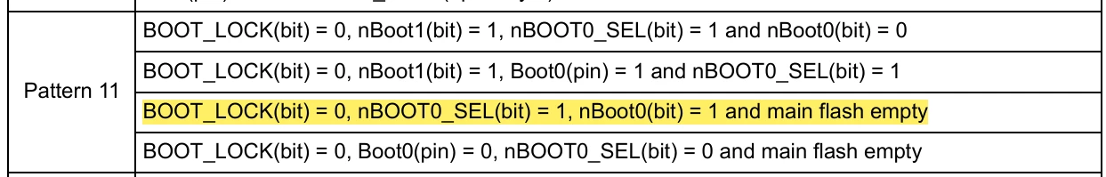

The correction makes sense.  However, I still dispute that the U0 is pattern 11.  @TDK pointed out the definition of Pattern 11 earlier in the thread:
Existing definition of Pattern 11Existing definition of Pattern 11
According to this chart, if the device is not locked, and neither the nBOOT0_SEL nor nBoot0 bits have been programmed (i.e. they are each set to 1 from the factory), then if the main flash is empty, the bootloader should start automatically.  Based on my previous testing, I did not find this to be the case.
Has your expert confirmed that a factory-new U083 or U073, when powered up, automatically enters the bootloader?
