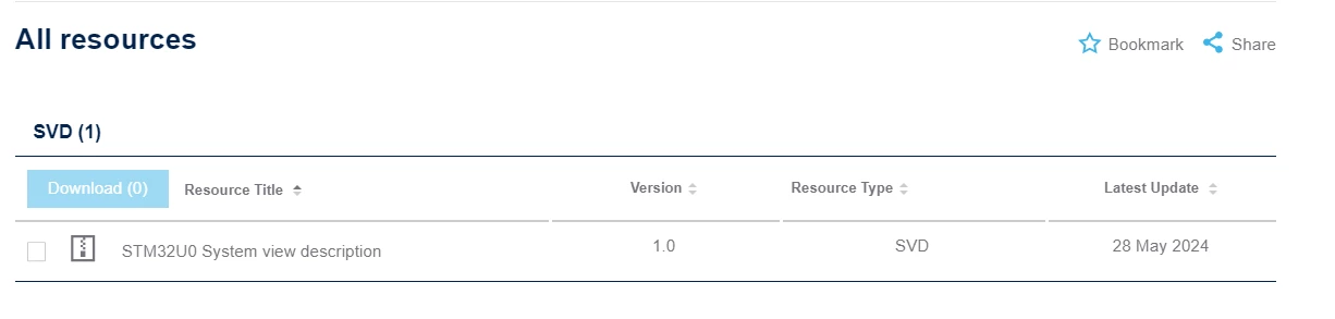

Hello @Stephan W. ,
Now, the STM332U031 SVD file is available in CAD resources.
Thank you for your Contribution in STCommunity.
Kaouthar

May 21, 2024
Hello @Stephan W. ,
Thank you for bringing this issue to our attention. I will check internally.
A temporary solution, you can find the all .svd files under STM32Cubeprogrammer installation folder "C:\Program Files\STMicroelectronics\STM32Cube\STM32CubeProgrammer\SVD".
In the attachment STM32U031.svd file.
I hope this help you.
Sorry for any inconvenience.
Kaouthar

Hello @Stephan W. ,
Kaouthar
