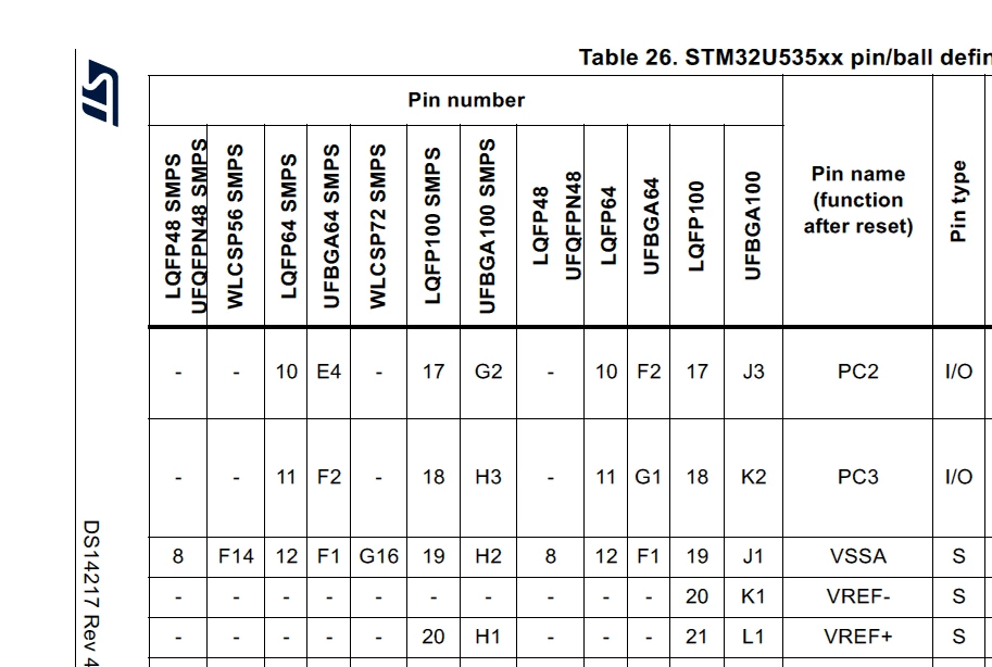

which U535 ?
see ds:
100pin case has vref+.

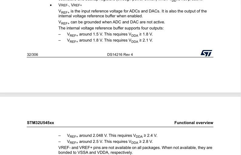

I just now inspect some of the pages of datasheet. It refer to some four levels of Vref voltage. If i understand correctly, i must supply the Vdda pins with certain amount of voltage. But i am curious about if it is enough to supply Vdda pin with just amount of voltage or am i have to program some kind of registers etc. ?stm32_vref issue.png

What voltage IS your supply ?
-> If maybe 2.5V, you only can use the 2.xx Vref to measure the reference. (The reference needs some headroom to the supply VDDA (bonded to VREF+ , so same).

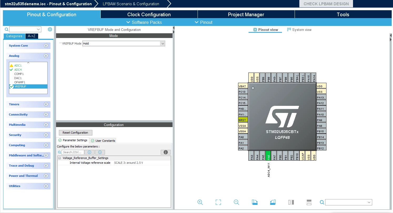

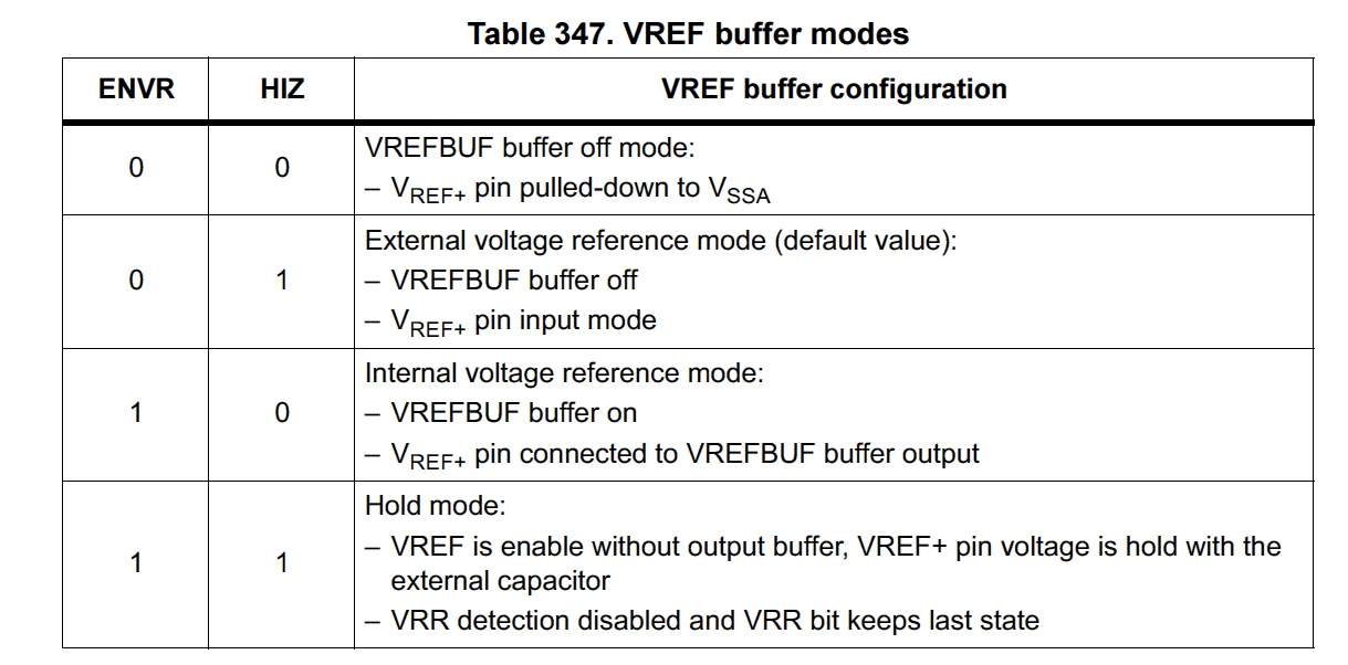

If we adjust Vrefbuf as HOLD to 2.5V, does the adc have 2.5V reference voltage? Some of the code is attached.software.png

Still no answer.   What voltage IS your supply ?
see U535 maual:

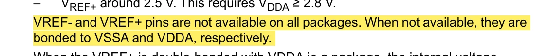

But VREF+ is not on a pin on your chip. So - what then ??

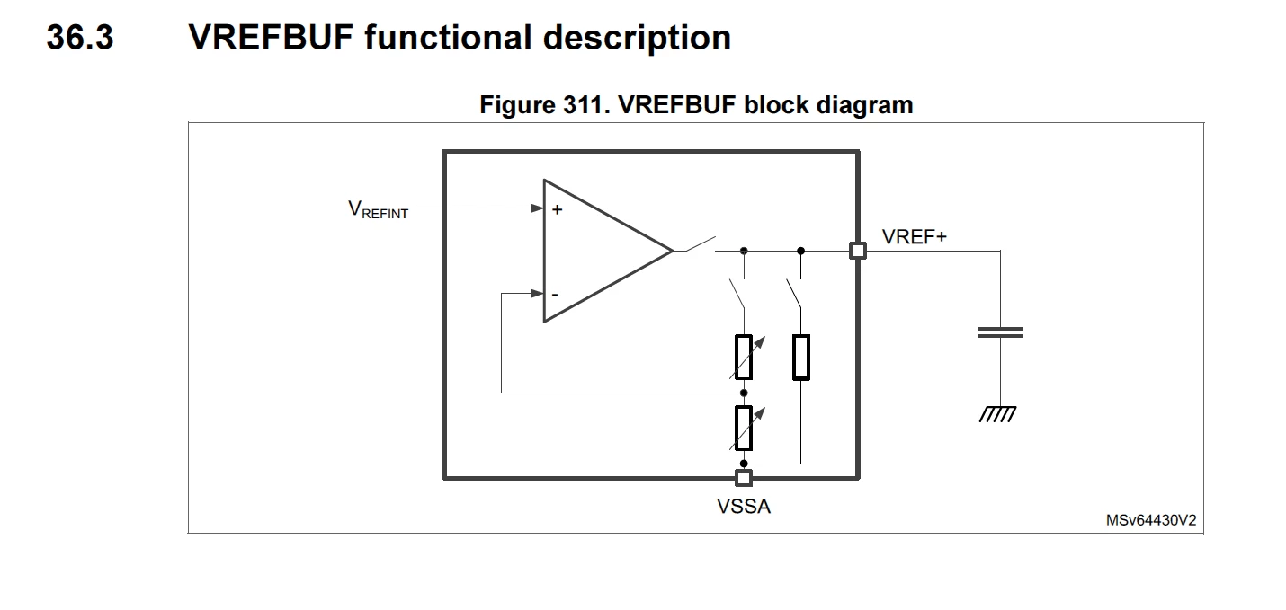

As VREF is connected to VDDA, I suggest to connect VDDA to an external reference voltage. The power consumption on VDDA is low as it supplies only ADC, DAC, comparators and opamp (cf datasheet).
Bertrand
September 24, 2024

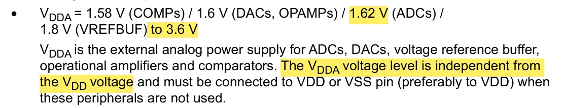

As we supply the Vdd with 3.3V and Vdda with 2.5V individually, i can get 2.5V reference voltage? Am i understand you correctly?
September 24, 2024
Yes. Relevant datasheet statements are here:
