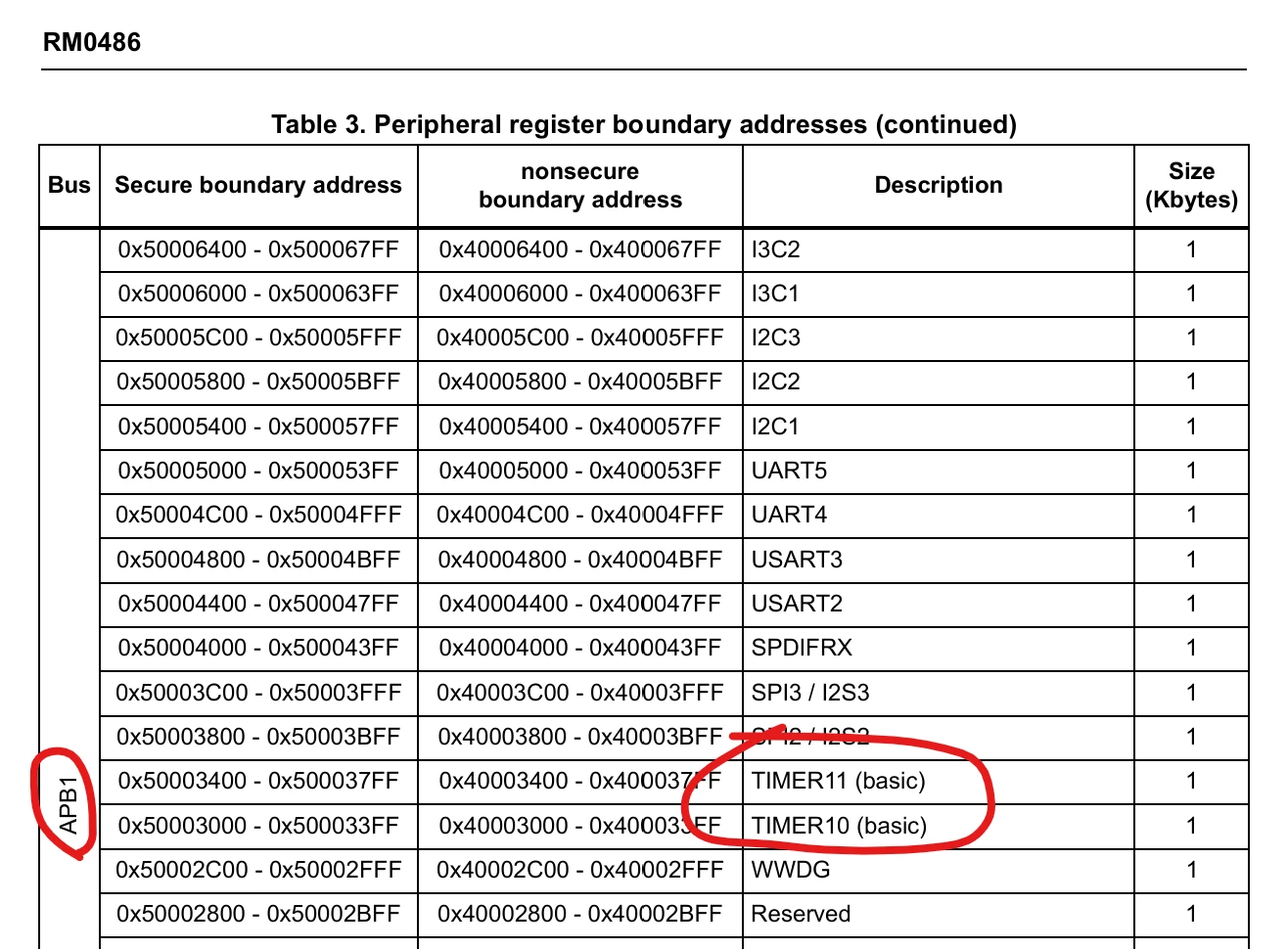

Go to the reference manual in the "Peripheral register boundary addresses" table and you can see which timer is within which APB.

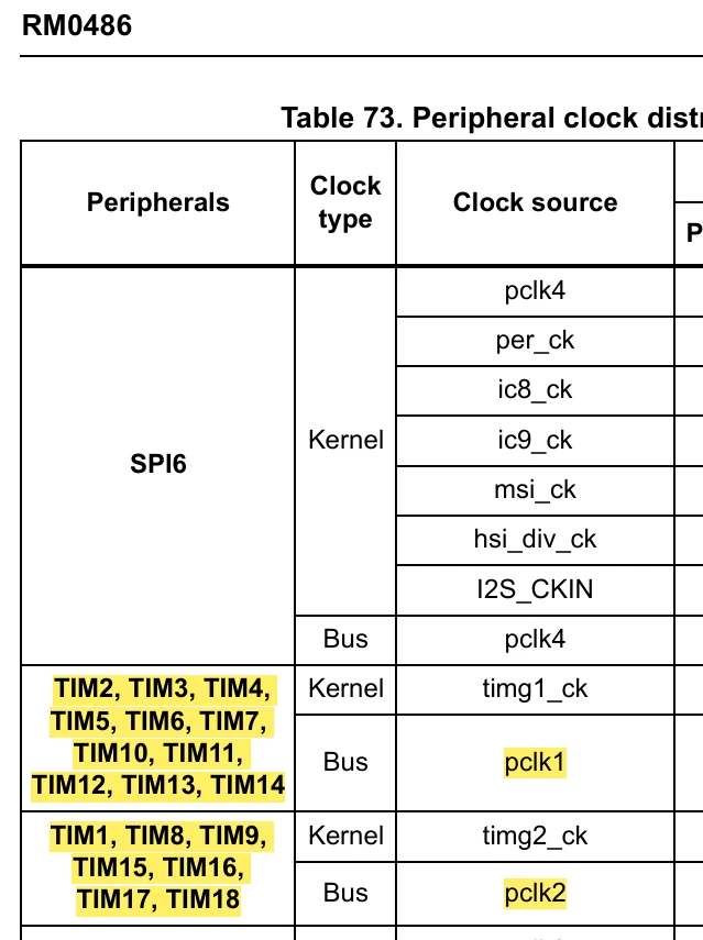

The "timer group clock" is a separate clock you can use to clock individual timers. See timgx_ck below
It's also listed here which PCLK goes with which timer:

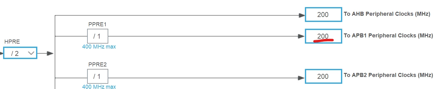

I missed that in the "Peripheral register boundary addresses".  I guess I do not know what "PClkx" is and where it comes from.  I am using STM32CubeMX and am confused on how to set the clocks for the timers.  Nothing seems to match with the documentation.  What are the "Timer Clock Group" clocks.
Jul 24, 2025 1:11 AM UTC
pclk1 is the APB1 clock here:

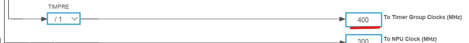

timer group clocks is this:
This is in the CubeMX clock tree which helps visualize it, but it should match the RM. What isn't matching the documentation?
