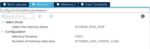

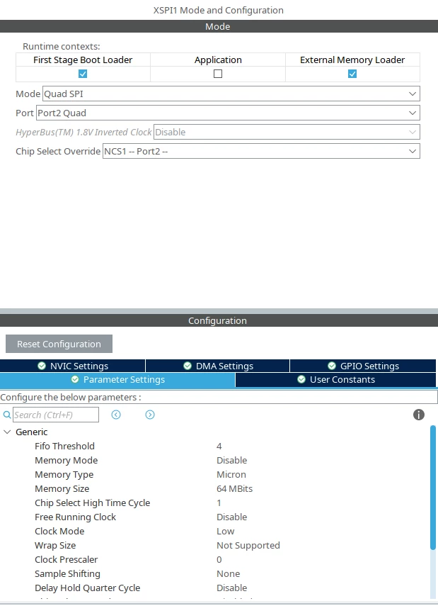

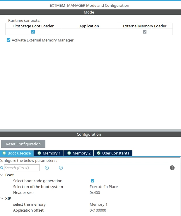

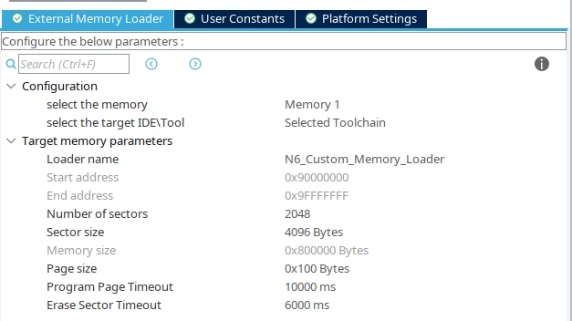

I have checked that link and modified my project configuation based on”W25Q64JV” NOR flash. To be compatible with the default setings to read from XSPI1/Single line, I also modified the project configuartion to use XSPI1.
Still not able to run from the flash.
Now the configuation looks like this:
  • For XSPI1:
  • For MXSPI:
  • For EXTMEM_MANAGER:
and
  • For EXTMEM_LOADER:

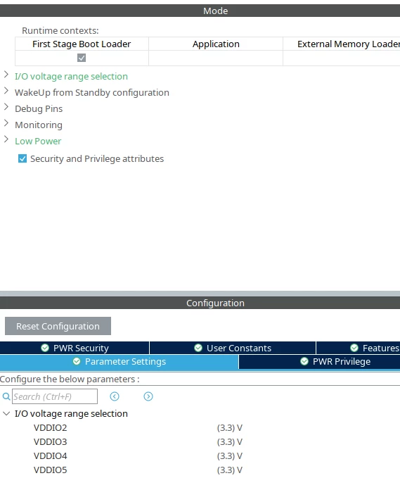

  • PWR
