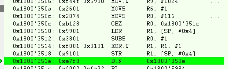

Hi, I'm unable to debug the template project, once debug session is launched the core just stucks in the bootrom:

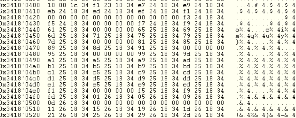

The RAM content is correct:

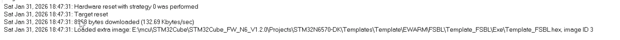

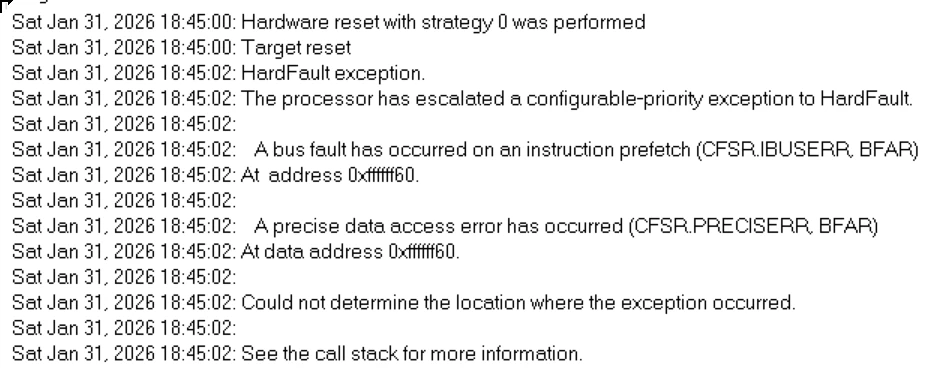

Also I suggest change execUserSetup into execUserReset in setup.mac, as execUserSetup is only executed once debug session is launched, while execUserReset is also executed when Reset button is pressed.
Since AXIRAM2 is erased on reset code need to be redownloaded.
Before:
After:
