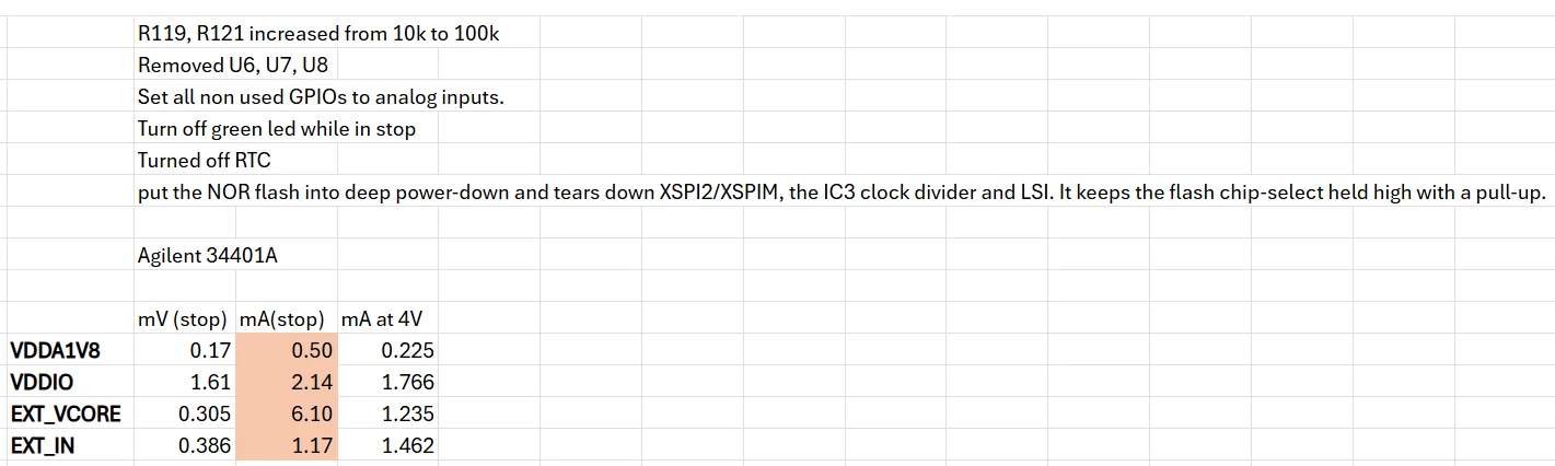

Hello ST,
I have used this project
\STM32CubeN6\Projects\STM32N6570-DK\Examples\PWR\PWR_STANDBY_RTC
I have modified the project so that it enters stop mode instead of standby. The code that enters stop mode is put in a while(1) loop that looks like this
while(1)
  HAL_SuspendTick();
  HAL_PWR_EnterSTOPMode(0, PWR_STOPENTRY_WFI);
  SystemClock_Config();
  HAL_ResumeTick();
  Toggle_leds(); // toggles the green led 50 times
All unused Gpios are set as analogue inputs
Turned off RTC (wake up by button press instead)
put the NOR flash into deep power-down and tears down XSPI2/XSPIM, the IC3 clock divider and LSI. It keeps the flash chip-select held high with a pull-up.
Is the measured current higher than expected? How come VDIO is so high? VDDA1V8 can also be reduced i think, but how?
