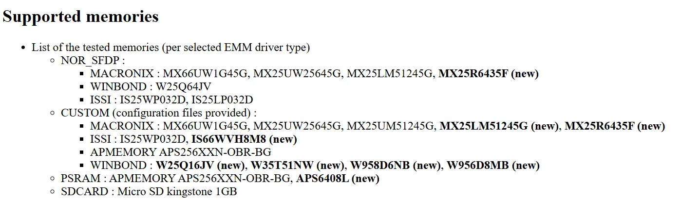

STM32N6570 compatible SPI Flash as MX25UW51245GXDQ00-T is not stock
Currently we are developing an AI Industrial camera using STM32N6570, we are exploring the compatible SPI Flash for the implementation. Could you share your recomendation of 1Gb Octal SPI Flash.

Hello ​@nvzentechnologies and welcome to the community,
I recommend you to refer to the release notes files to find the supported memories: STM32Cube_FW_N6_V1.2.0/Middlewares/ST/STM32_ExtMem_Manager/Release_Notes.html
Thank you.
