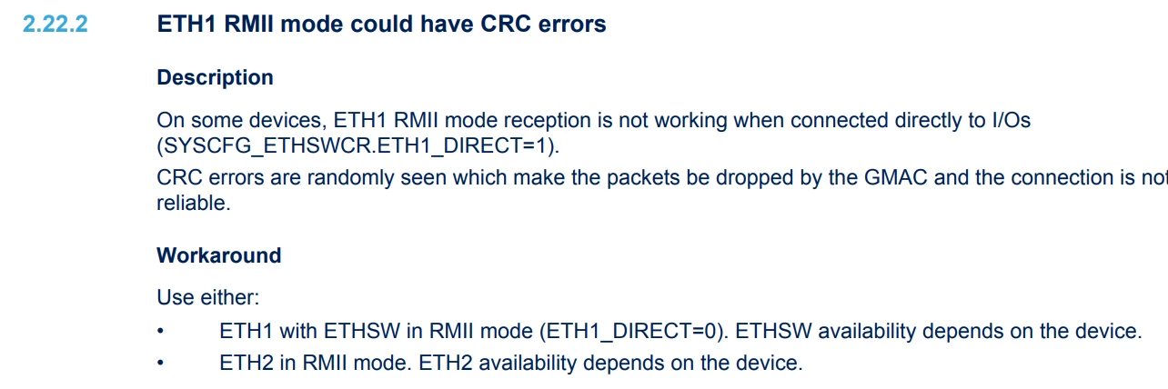

​@jordydehoon.heraeus ,
According to our internal team, it seems to be the same errata described in the STM32MP2 product errata sheet ES0598, section 2.22.2, “ETH1 RMII mode could have CRC errors”:
We now have strong reasons to believe that the STM32N6 is affected by the same issue/errata that was previously discovered on the STM32MP25 RMII RX path.
Further internal investigations are required with the STM32N6 design team to determine whether the design surrounding the N6 Ethernet MAC may exhibit the same timing violation between CLK_RMII and CLK_RMII/2.
This analysis will allow us to confirm the root cause, validate the final erratum description, and determine whether a possible workaround for STM32N6 in RMII mode can be identified and included in the next revision of ES0620.
Following these investigations, we will provide an action plan and schedule for publishing:
  • An update to the Errata Sheet (ES0620)
  • Any required updates to the Datasheet.
  • Any required updates to the Reference Manual.
  • Any required updates to the Ethernet RMII reference design documentation (AN5967).
We don’t want to commit on the release date of the documents. So here you are informed.

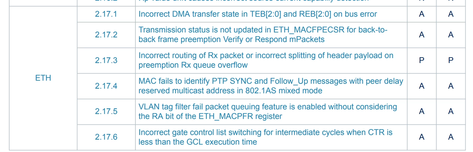

Hello ​@jordydehoon.heraeus and welcome to the ST community,
Did you check the product errata sheet/Section ETH?
Jul 14, 2026 2:05 PM UTC
  Yes, we went through ES0620 Rev 4, Section 2.17 (ETH). The six ETH errata there cover the DMA transfer-state bits
  on a bus error (2.17.1), frame-preemption/FPE status reporting (2.17.2–2.17.3), PTP 802.1AS SYNC identification
  (2.17.4), VLAN tag-filter queue routing (2.17.5), and TSN gate-control-list switching (2.17.6). None of them match
  what we're seeing, and none of those features are even enabled here — we run a plain single-queue RMII setup with
  no FPE, PTP, VLAN filtering or TSN.
  Our symptom is different: the RMII receive sampling phase seems to be latched at MAC reset and occasionally lands
  misaligned, producing RDES3.DE/ES and MMC alignment errors (CRC errors stay at zero), and it reproduces in PHY
  internal digital loopback with no cable or link partner. There's nothing in the ETH errata section describing this.
  So the real question is whether this is a known but undocumented limitation of the N6 EQOS RMII adapter, and
  whether there's a supported way to get a deterministic RMII sampling phase at init instead of resetting the MAC
  until a self-test passes. I'm happy to share the full boot self-test log (a bad boot and a good boot) if that would
  help.
