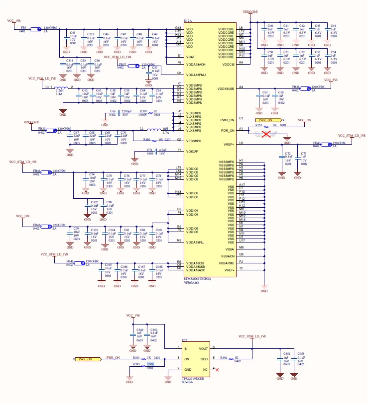

In our design, we are using VDD and VDDIO2-5 all at 1.8V level and turn on with below sequense
When 1.8V available, below domains are turn on.
  1. VDD
  2. VBAT
  3. VDDA18AON
  4. VDDIO4
  5. VDDIO5
  6. VDDA18PLL
  7. PDR_ON
Once PWR_ON signal is available from STM32N657 MCU
  1. VDDIO2
  2. VDDIO3
  3. VDDA18CSI
  4. VDDA18USB
  5. VDDA18ADC
  6. VDDSMPS (using internal SMPS)
  7. VDDA18PMU
  8. VREF+
Below is schematic reference

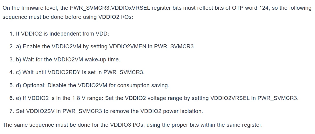

While revieing reference from STM side regarding “How to program the OTP fuse bits in the STM32N6”
I found that there is particular sequence is mentioned as per below
So could you please guide us there any particular sequence do we need to follow because we are using all power domains at 1.8V.
Thanks
RomainR.
Oct 31, 2026 9:06 AM UTC
Hi ​@kadam
Figure 2, "STM32N6 power-on sequence (two steps execution)" in AN5967, shows that it is possible to group some or all VDDIOx supplies together, or to make them independent of VDD. This in 3.3V or 1.8V.
This is your case, since VDDIO2/VDDIO3 are sequenced by PWR_ON, while VDD/VDDIO4 and VDDIO5 are powered up first.
When all supplies are configured at 1.8 V, this does not change anything. TheVDDIOxVSEL configuration sequence should be implemented in your firmware, at a very early stage (at the beginning of the FSBL), and before using any peripherals powered by VDDIO2 to VDDIO5 (external memories or SDMMC).
But, the OTP word 124 must be programmed one time first.
You can refer to the following example:
https://github.com/STMicroelectronics/STM32CubeN6/blob/main/Projects/STM32N6570-DK/Examples/XSPI/XSPI_PSRAM_MemoryMapped/FSBL/Src/stm32n6xx_hal_msp.c
https://github.com/STMicroelectronics/STM32CubeN6/blob/main/Projects/STM32N6570-DK/Examples/XSPI/XSPI_NOR_MemoryMapped_DTR/FSBL/Src/stm32n6xx_hal_msp.c
