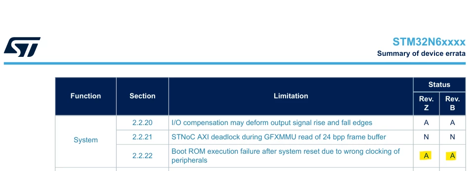

I found a discussion on the ST Community that describes almost exactly the same behavior:
  • first boot after power-on works,
  • after XSPI1 initialization, any reset prevents the BootROM from starting,
  • only a complete power cycle restores normal operation.
The discussion also mentions Errata ES0620, section 2.2.23, concerning modifications of RCC clock selection registers (CCIPR6/7/8/13), which may prevent the BootROM from booting correctly after a reset.

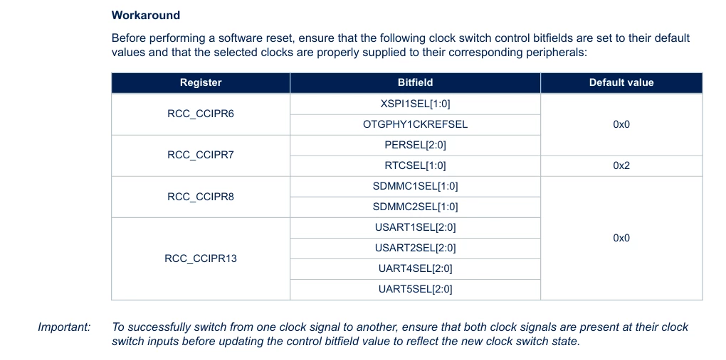

2. Keep RCC->CCIPR6.XSPI1SEL at its reset value
The second issue was inside the application.
If the application uses XSPI1 (for example with APSRAM), do not modify the XSPI1SEL field in RCC->CCIPR6.
Leave both bits at their reset value:
XSPI1SEL = 0
which means the XSPI1 kernel clock is sourced from HCLK5.
Instead of changing the clock source, simply adjust the XSPI clock divider to obtain the required operating frequency.
Once I stopped modifying XSPI1SEL, the problem completely disappeared.

Hello ​@Franzi.Edo ;
The erratum 2.2.22 Boot ROM execution failure after system reset due to wrong clocking of peripherals in the ES0620 is a silicon issue in Rev Z and Rev B.
The only granted workaround is shared in the erratasheet is
Currently, there is no silicon Revision that fixes the issue.
Thank you for your contribution in STCommunity.
