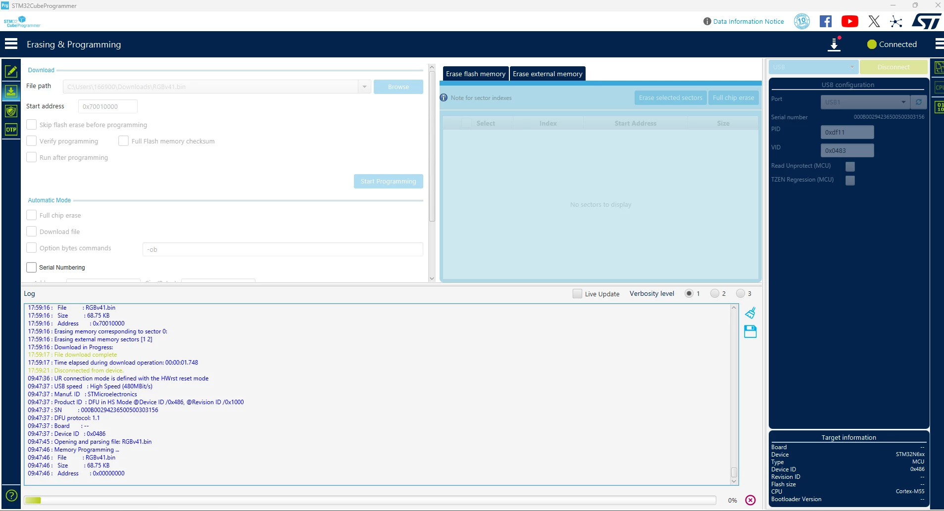

We have tried to program STM32N657 through STM32Cube programmer using USB1 interface. But we are not able flash code into external flash.

Hello Team,
We are making BOOT0 pin as high and BOOT1 pin as low during flashing through USB1 port. In STM32CubeProgrammer, programming process show continuous and at the end flashing does not completed.
I have attached image for reference.
Thanks.
Chloe Meunier
Jun 17, 2026 8:38 AM UTC
did you move the jumper JP2 to position 3-4, and connect the laptop to CN18?
kadamAuthor
Jun 19, 2026 1:11 PM UTC
Hello Chloe,
Yes, we are placing jumper JP2 to position 3-4 and connecting USB cable on connector CN18.
Is there method is there for flashing through USB1 port?
Thanks
