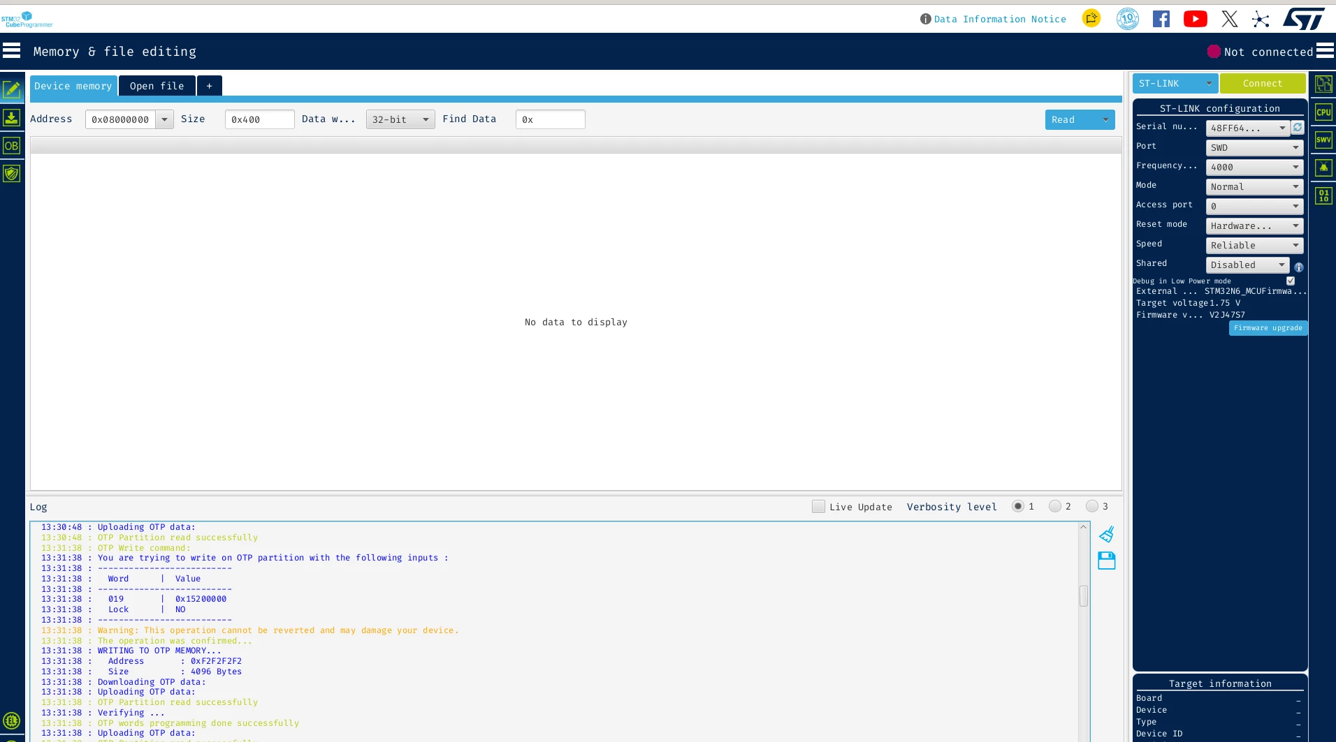

We have a custom STM32N657Z0H3Q board on which BOOT1 is routed to PN10 instead of the default PA6.
To configure the Boot ROM to sample BOOT1 from PN10, we programmed OTP Word 19 (BOOTROM_CONFIG_10) as described in RM0486 Rev. 4, Section 5, Table 18:
  • dev_boot_port [24:21] = 9 → Bank N (PN) → 9 << 21 = 0x01200000
  • dev_boot_pin [28:25] = 10 → Pin 10 → 10 << 25 = 0x14000000
  • OTP19 = 0x15200000
Steps Followed
  1. Before programming, we read OTP through SWD. OTP19 was 0x00000000, with status 0x00000000, indicating that it was unprogrammed and not write-locked. SWD/ST-LINK access was working normally.
  2. We programmed OTP19 with 0x15200000 using STM32CubeProgrammer v2.23.0, without enabling the lock option. The tool reported:
    • "OTP words programming done successfully"
  3. After the next power cycle/reboot, the device no longer enters Development Boot. Instead, it boots from Flash, and our FSBL and application start running normally. SWD/debug access is no longer available.
