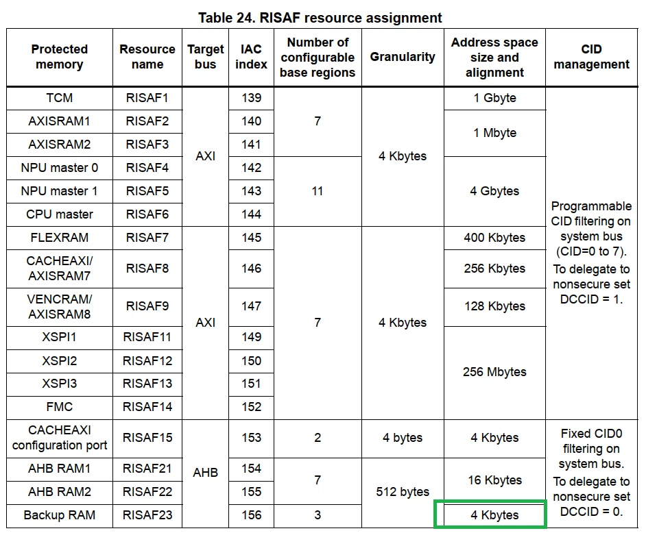

First off, Backup RAM is 8 KB, but RISAF area for that is 4 KB:
When defining full 8 KB Backup RAM area in CubeMX MMT and let it automatically do RISAF configuration and generate SystemIsolation_Config, then that will fail in assert because RISAF23_LIMIT_ADDRESS_SPACE_SIZE is 4KB (minus 1) not 8 KB (minus 1). Assert is valid based on RM table 24, but tool creates bad code.
Okay, so I used first 4 KB.

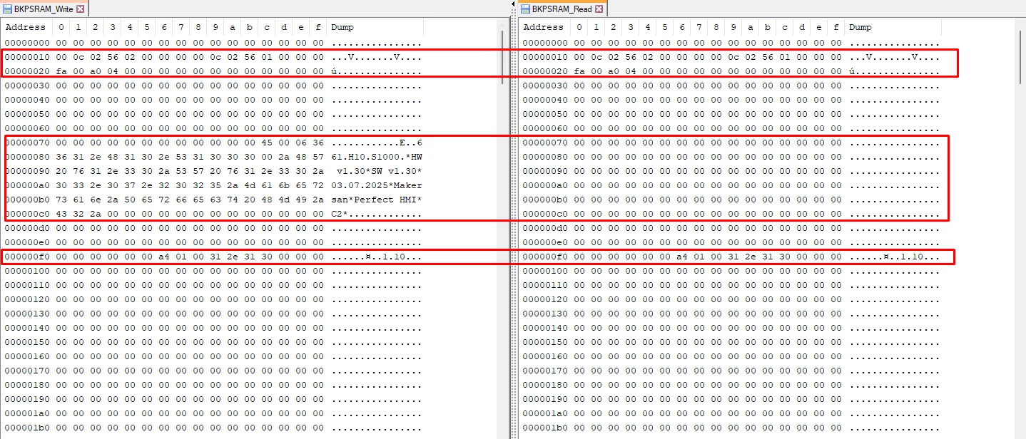

But that was not enough. Written data still did not persist over resets.
I have MPU configured (by MMT) over Backup RAM area and it is made non-cacheable with attributes. Unfortunately this doesn't seem to have effect, because only when I added manual cache flush (clean) and invalidate operations, it started working like expected.

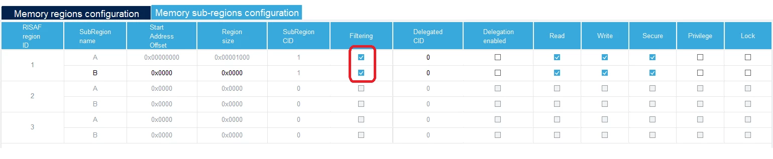

One alternative to avoid disabling whole RISAF or applying custom changes to generated code is to set filtering on the Backup RAM area:
