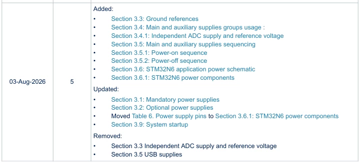

I’m currently trying to design a STM32N645I0H based board with LAN8742A Ethernet. Right as for the STM32H723 I would prefer to have one NZ2520SH-25MHZ-END4869C 25 MHz crystal for both, the MCU (fed into OSC_IN) and the PHY. The application note says, this is possible and for such kind of analogue clock input OSC_OUT has to be tied to VDD via a 1K resistor.
What the AN does NOT say: which VDD is meant? The 3.3V rail or the 1.8V rail?

It was AN5967 and now it seems to be corrected, now it specifies VDDA18AON :-D

Hello ​@HMüll.4 ,
Thank you for updating post.
You are right a new revision of AN5967 is published in 03-Aug-2026.
Thank you for your contribution in STCommunity.
