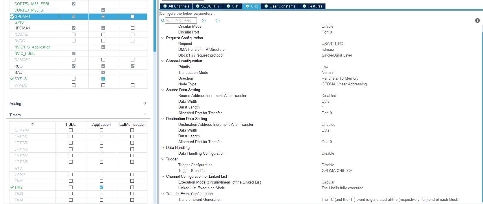

When I was using STM32N6, I tried to generate USART with STM32CubeMx, but when you enable DCache the DMA did not properly handle USART-RX data.

KDJEM.1
August 11, 2026
Hello ​@xukong ;
Are you get the same issue when testing an available example UART_ReceptionToIdle_CircularDMA?
Could you please share the ioc file?
I think the SystemClock_Config is missing in your code.
Thank you.
Kaouthar
xukongAuthor
August 11, 2026
I've already found the problem, but I still don't know why. If you're sure, could you please let me know?
The problem lies below:
First solution:
    SCB_DisableDCache();
if (HAL_UARTEx_ReceiveToIdle_DMA(&huart1, s_ulDebugUsartRxDmaFifo, sizeof(s_ulDebugUsartRxDmaFifo)) == HAL_OK) {
ret = true;
SCB_EnableDCache();
Second solution:
DMA_NodeTypeDef Node_GPDMA1_Channel0;
This variable should have no buffering.
